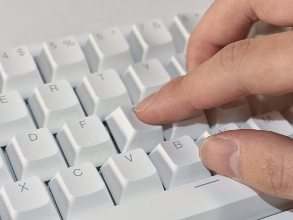

How to Clean Wooting Keyboard Lekker Linear45 Switches
  1. How to Clean Wooting Keyboard Lekker Linear45 Switches, How to Clean Wooting Keyboard Lekker Linear45 Switches: crwdns2935265:01crwdnd2935265:01crwdnd2935265:03crwdne2935265:0 How to Clean Wooting Keyboard Lekker Linear45 Switches, How to Clean Wooting Keyboard Lekker Linear45 Switches: crwdns2935265:01crwdnd2935265:02crwdnd2935265:03crwdne2935265:0 How to Clean Wooting Keyboard Lekker Linear45 Switches, How to Clean Wooting Keyboard Lekker Linear45 Switches: crwdns2935265:01crwdnd2935265:03crwdnd2935265:03crwdne2935265:0

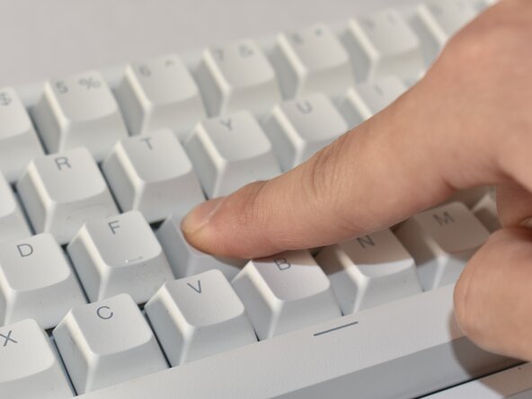

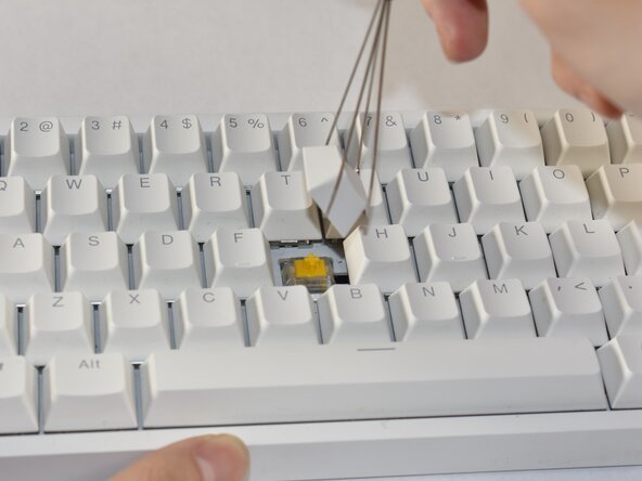

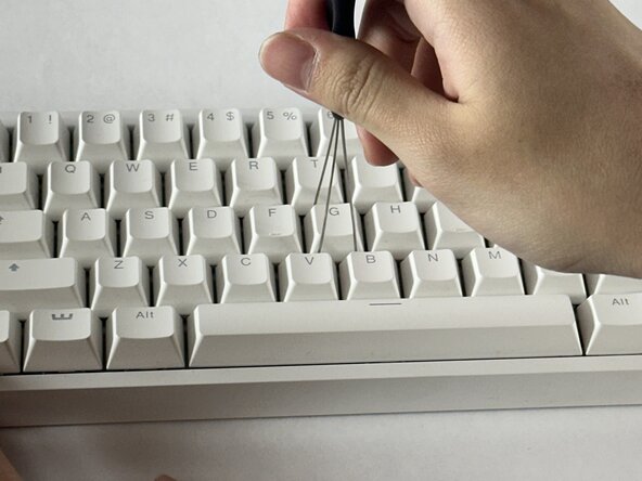

    • Align the keycap puller so the prongs wrap underneath the sides of the keycap, then pull up to remove the keycap.

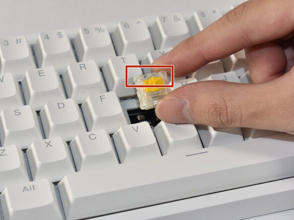

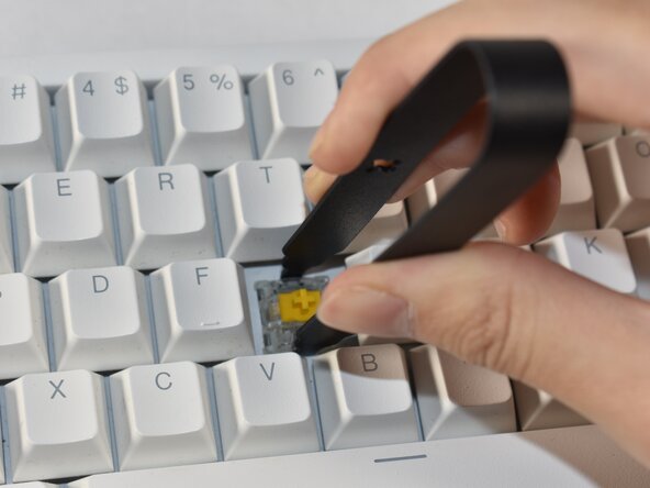

    • Align the prongs of the switch puller so it clips underneath the grooves of the north and south side of the switch, then pull up.
    • Ensure a strong grip of the switch so the puller doesn’t slip out while pulling.
    • If you require an entire switch replacement, skip to Step 9 to re-insert the new switch.

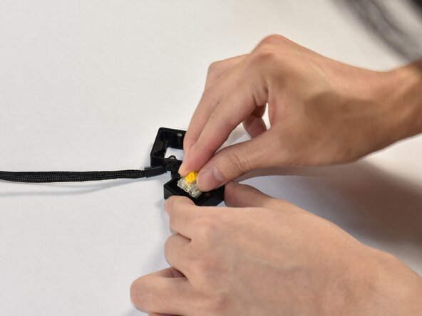

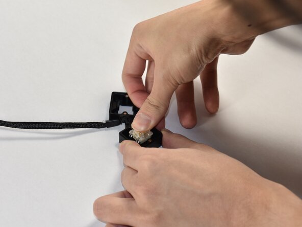

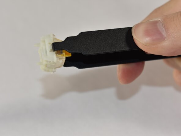

    • Identify the four prongs on the switch opener.
    • Align the switch onto the switch opener so that it sits flush on the prongs, then push down on the switch to disassemble the switch.
    • If you only want to replace the spring, move to Step 6 after disassembling the switch.

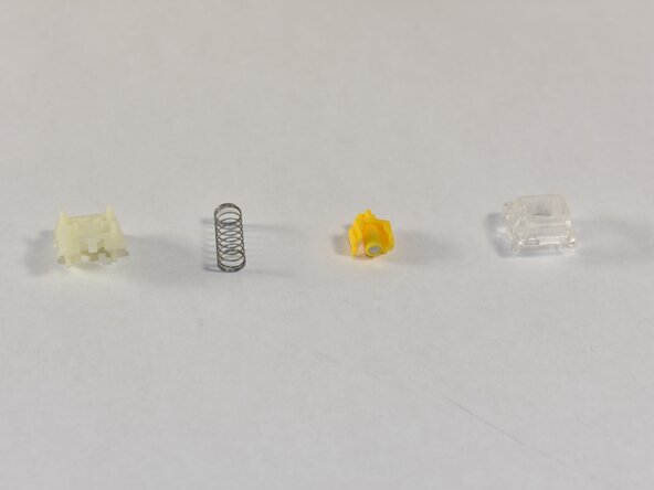

    • Identify the various switch components and the order of construction (from left to right or bottom to top): bottom housing, spring, stem, top housing. Separate them from the switch.

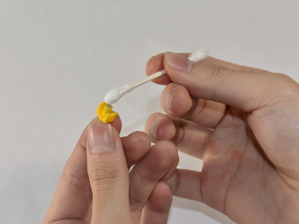

    • Identify the individual parts and see if any parts are dirty to the degree that it could interfere with the magnet sensor.
    • Clean out the dust or debris thoroughly with a cotton swab.
    • Optional: In the case where extensive cleaning is required, use isopropyl alcohol.

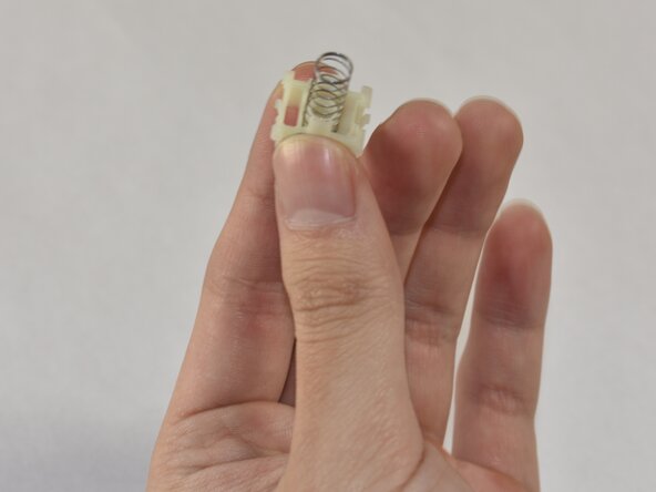

  6. How to Clean Wooting Keyboard Lekker Linear45 Switches: crwdns2935265:06crwdnd2935265:01crwdnd2935265:02crwdne2935265:0 How to Clean Wooting Keyboard Lekker Linear45 Switches: crwdns2935265:06crwdnd2935265:02crwdnd2935265:02crwdne2935265:0
    • Hold the bottom housing such that the inner cylinder faces up.
    • Slip the spring onto the cylinder.

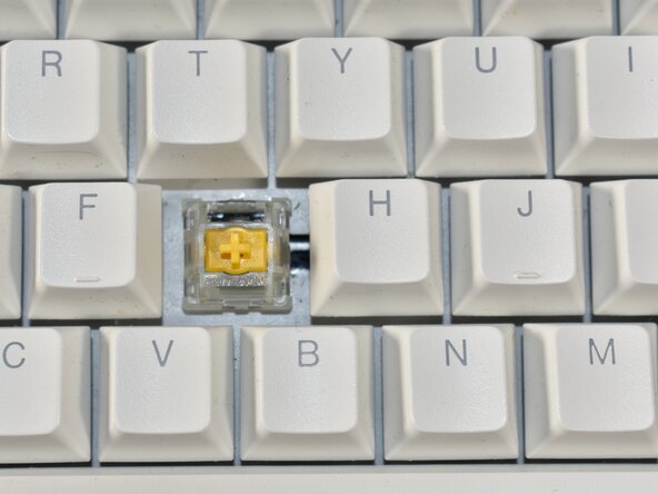

  9. How to Clean Wooting Keyboard Lekker Linear45 Switches: crwdns2935265:09crwdnd2935265:01crwdnd2935265:03crwdne2935265:0 How to Clean Wooting Keyboard Lekker Linear45 Switches: crwdns2935265:09crwdnd2935265:02crwdnd2935265:03crwdne2935265:0 How to Clean Wooting Keyboard Lekker Linear45 Switches: crwdns2935265:09crwdnd2935265:03crwdnd2935265:03crwdne2935265:0
    • Align the switch into the board such that the LED window is facing north.
    • Push down so the switch clips into place and isn’t loose.
