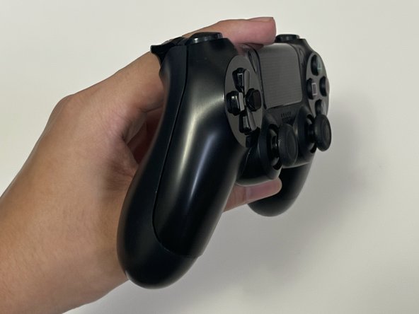

How to Clean The R2 and L2 Buttons on a Dualshock 4 CUH-ZCT2 Controller
  1. How to Clean The R2 and L2 Buttons on a Dualshock 4 CUH-ZCT2 Controller, How to Clean the L2 and R2 Buttons: crwdns2935265:01crwdnd2935265:01crwdnd2935265:02crwdne2935265:0 How to Clean The R2 and L2 Buttons on a Dualshock 4 CUH-ZCT2 Controller, How to Clean the L2 and R2 Buttons: crwdns2935265:01crwdnd2935265:02crwdnd2935265:02crwdne2935265:0

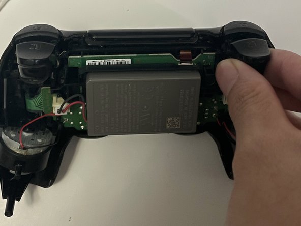

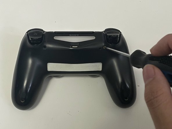

    • Use a Phillips #00 screwdriver to remove the four 6.0 mm screws located on the back of the controller.
  2. How to Clean The R2 and L2 Buttons on a Dualshock 4 CUH-ZCT2 Controller: crwdns2935265:02crwdnd2935265:01crwdnd2935265:03crwdne2935265:0 How to Clean The R2 and L2 Buttons on a Dualshock 4 CUH-ZCT2 Controller: crwdns2935265:02crwdnd2935265:02crwdnd2935265:03crwdne2935265:0 How to Clean The R2 and L2 Buttons on a Dualshock 4 CUH-ZCT2 Controller: crwdns2935265:02crwdnd2935265:03crwdnd2935265:03crwdne2935265:0

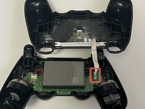

    • Separate the front and the back of the controller by pulling both pieces apart at the same time.
    • Be very careful and gentle when pulling the shells apart because the blue ribbon can become detached and damaged.

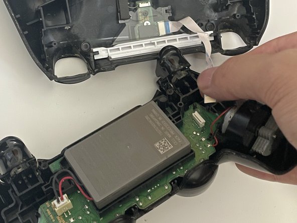

  3. How to Clean The R2 and L2 Buttons on a Dualshock 4 CUH-ZCT2 Controller: crwdns2935265:03crwdnd2935265:01crwdnd2935265:02crwdne2935265:0 How to Clean The R2 and L2 Buttons on a Dualshock 4 CUH-ZCT2 Controller: crwdns2935265:03crwdnd2935265:02crwdnd2935265:02crwdne2935265:0
    • Carefully unplug the blue ribbon from the body of the controller shell.

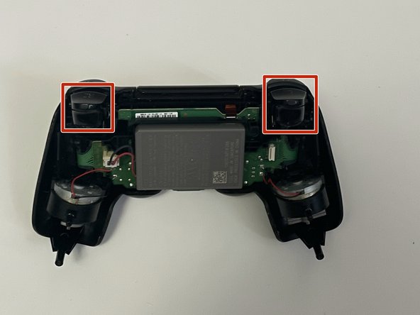

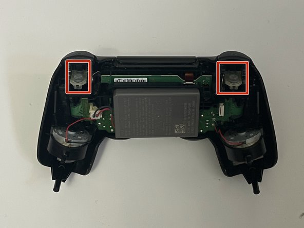

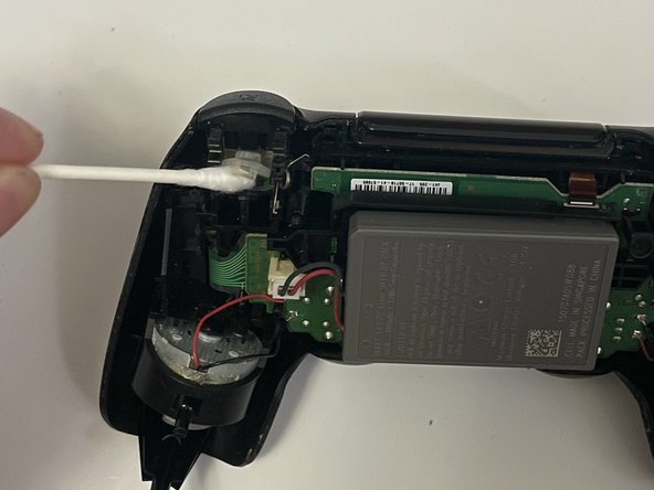

    • Remove the left and right triggers by wiggling the buttons sideways until they are completely off.
  5. How to Clean The R2 and L2 Buttons on a Dualshock 4 CUH-ZCT2 Controller: crwdns2935265:05crwdnd2935265:01crwdnd2935265:02crwdne2935265:0 How to Clean The R2 and L2 Buttons on a Dualshock 4 CUH-ZCT2 Controller: crwdns2935265:05crwdnd2935265:02crwdnd2935265:02crwdne2935265:0
    • Take the Q-tip and soak it into the isopropyl alcohol.
    • Clean around the trigger button area as well as under and above the rubber padding.

    • Screw the four 6.0mm screws on the back of the controller using the Phillips #00 screwdriver.
