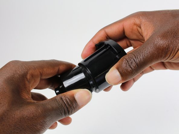

    • Remove K-Cup Pack Holder Assembly by pinching the left and right sides to release clamp. Wiggle slightly to remove
  3. How to Clean The Exit Needle of the Keurig B60: crwdns2935265:03crwdnd2935265:01crwdnd2935265:03crwdne2935265:0 How to Clean The Exit Needle of the Keurig B60: crwdns2935265:03crwdnd2935265:02crwdnd2935265:03crwdne2935265:0 How to Clean The Exit Needle of the Keurig B60: crwdns2935265:03crwdnd2935265:03crwdnd2935265:03crwdne2935265:0

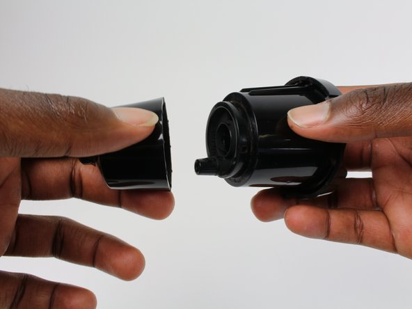

    • Pull and snap apart the funnel from the K-Cup Pack Holder (If this is the first time separating the Pack Holder Assembly, more force may be required)
  4. How to Clean The Exit Needle of the Keurig B60: crwdns2935265:04crwdnd2935265:01crwdnd2935265:02crwdne2935265:0 How to Clean The Exit Needle of the Keurig B60: crwdns2935265:04crwdnd2935265:02crwdnd2935265:02crwdne2935265:0
    • Insert a paperclip or other small, sharp object into the bottom of the K-Cup Pack Holder needle compartment to clear out any debris. If debris is too dry and compact, perform this step under running water to loosen the debris
    • Flip K-Cup Pack Holder and repeat
