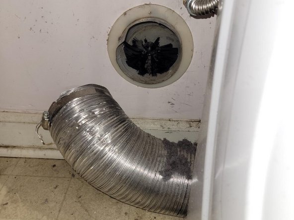

    • Pull your dryer away from the wall and disconnect the dryer vent from the wall.
    • Make sure your dryer is not running before removing vent cover.
    • In this case, there was one screw connecting the vent to the wall.
    • Simply remove the screw and pull the vent from the wall.

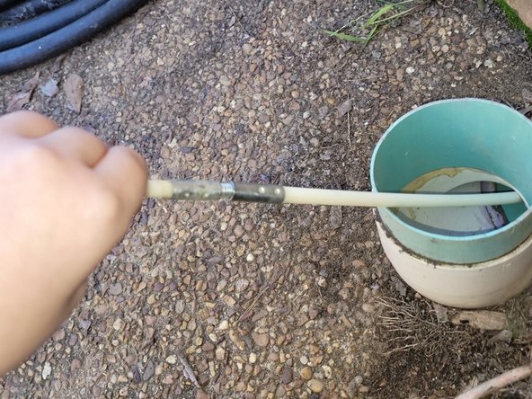

    • Connect the main cleaning brush extension to the end of a drill.
    • Insert the cleaning extension into the vent and run it down the vent by pulling the trigger of the drill.
  4. How to Clean Out a Dryer Vent: crwdns2935265:04crwdnd2935265:01crwdnd2935265:03crwdne2935265:0 How to Clean Out a Dryer Vent: crwdns2935265:04crwdnd2935265:02crwdnd2935265:03crwdne2935265:0 How to Clean Out a Dryer Vent: crwdns2935265:04crwdnd2935265:03crwdnd2935265:03crwdne2935265:0
    • Add extensions to the end of the drill by disconnecting the main cleaning brush from the end of the drill.
    • Next, connect an extension to the drill mouth and screw the other end onto the main cleaning brush.
  5. How to Clean Out a Dryer Vent: crwdns2935265:05crwdnd2935265:01crwdnd2935265:02crwdne2935265:0 How to Clean Out a Dryer Vent: crwdns2935265:05crwdnd2935265:02crwdnd2935265:02crwdne2935265:0
    • Keep adding and running the extensions down the vent with the drill.
    • You will feel that the extensions can go no farther when it hits the end of the vent.
    • In this case, you can see the cleaning brush coming out on the other end of the vent.
  6. How to Clean Out a Dryer Vent: crwdns2935265:06crwdnd2935265:01crwdnd2935265:02crwdne2935265:0 How to Clean Out a Dryer Vent: crwdns2935265:06crwdnd2935265:02crwdnd2935265:02crwdne2935265:0
    • Pull the cleaning extensions back out by continuing to run your drill in the same direction and pulling backwards.
    • If you reverse your drill, the extensions could unscrew and get stuck in your dryer vent.
    • Unscrew and remove the extensions from the drill one by one as you pull the cleaning brushes out.
