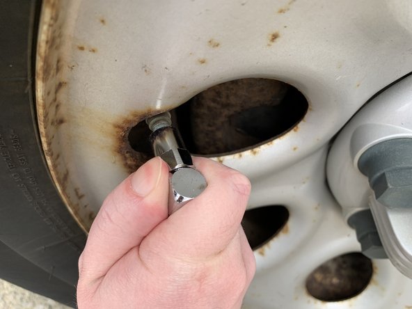

    • Each tire has a valve stem located on the outer part of the wheel that sticks out.
    • Remove the cap by unscrewing it counter-clockwise and set it off to the side.
    • The cap is very small, so be sure to keep track of it!
