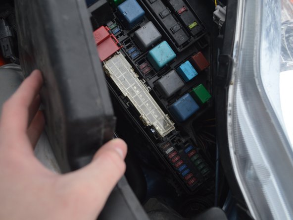

  5. How to Charge a Drained 2009 Toyota Prius Battery: crwdns2935265:05crwdnd2935265:01crwdnd2935265:02crwdne2935265:0 How to Charge a Drained 2009 Toyota Prius Battery: crwdns2935265:05crwdnd2935265:02crwdnd2935265:02crwdne2935265:0
    • Remove the cover off the fuse box by pressing the 2 tabs on the bottom and left side of the box
    • The second tab is located on the lowest part of the fuse box, and can be rather hard to see. The orange arrow points to where the tab is located.

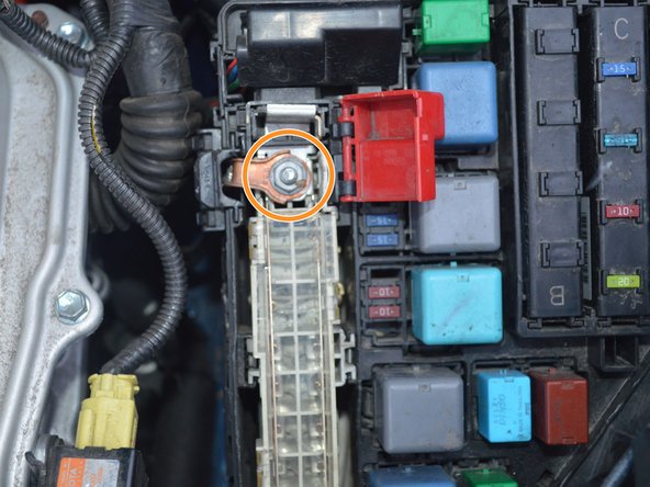

  6. How to Charge a Drained 2009 Toyota Prius Battery: crwdns2935265:06crwdnd2935265:01crwdnd2935265:02crwdne2935265:0 How to Charge a Drained 2009 Toyota Prius Battery: crwdns2935265:06crwdnd2935265:02crwdnd2935265:02crwdne2935265:0
    • Flip open the plastic red cover with a plus sign on it.
    • This is the positive terminal, and this is where the red lead is going to attach to.
  7. How to Charge a Drained 2009 Toyota Prius Battery: crwdns2935265:07crwdnd2935265:01crwdnd2935265:01crwdne2935265:0
    • Attach the positive RED lead to the positive terminal
    • If there is a small spark, it is okay, there is nothing wrong with that.
    • DO NOT let the red and black leads touch each other. This may cause an electric shock.
