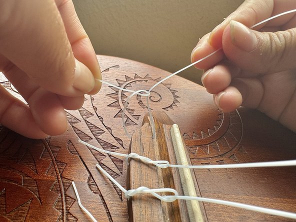

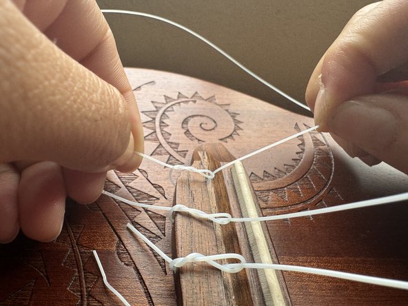

    • Leave approximately 4 inches so you are able to tie the knot.
    • To tie the strings in a double knot, make a loose knot with the strings.
    • Feed the string back through the opening (as seen in the second image).
    • Once it is fed through the opening, pull it tight.
    • Tug on the string to ensure it is secure to the bridge.

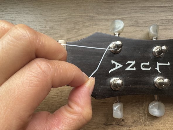

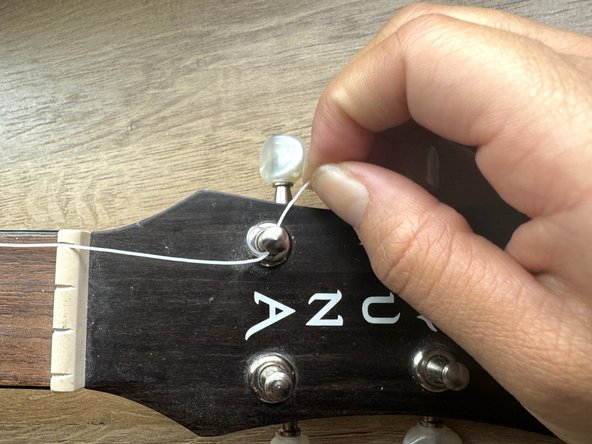

    • Once the strings are secured to the bridge, feed the strings through their corresponding tuning peg holes.
    • Wrap it around outwardly.
    • Feed it through the tuning peg again for a tighter fit.
  5. How to Change Ukulele Strings For Left Handed Players: crwdns2935265:05crwdnd2935265:01crwdnd2935265:01crwdne2935265:0
    • Ensure that the strings are wrapped around the tuning pegs from the inside out.
    • This image shows the direction the strings should be facing.
