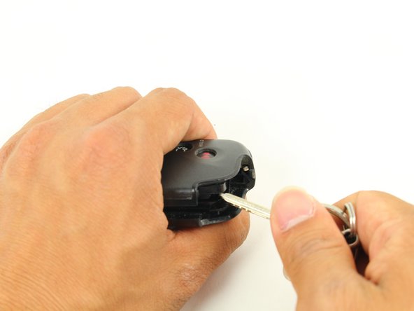

    • Place the key fob with the removable metal key facing towards you.
  2. How to Change Broken Buttons on your Lexus Key Fob: crwdns2935265:02crwdnd2935265:01crwdnd2935265:03crwdne2935265:0 How to Change Broken Buttons on your Lexus Key Fob: crwdns2935265:02crwdnd2935265:02crwdnd2935265:03crwdne2935265:0 How to Change Broken Buttons on your Lexus Key Fob: crwdns2935265:02crwdnd2935265:03crwdnd2935265:03crwdne2935265:0

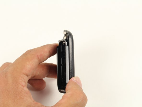

    • With the button side facing you, pull the metal latch down towards you to pull out the key.
  3. How to Change Broken Buttons on your Lexus Key Fob: crwdns2935265:03crwdnd2935265:01crwdnd2935265:03crwdne2935265:0 How to Change Broken Buttons on your Lexus Key Fob: crwdns2935265:03crwdnd2935265:02crwdnd2935265:03crwdne2935265:0 How to Change Broken Buttons on your Lexus Key Fob: crwdns2935265:03crwdnd2935265:03crwdnd2935265:03crwdne2935265:0

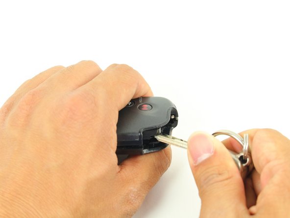

    • With the exposed corner facing you, place the metal key into the slot.
    • Turn the key sideways to open the key fob.
    • You may feel like you're breaking the key fob, but be firm while twisting.

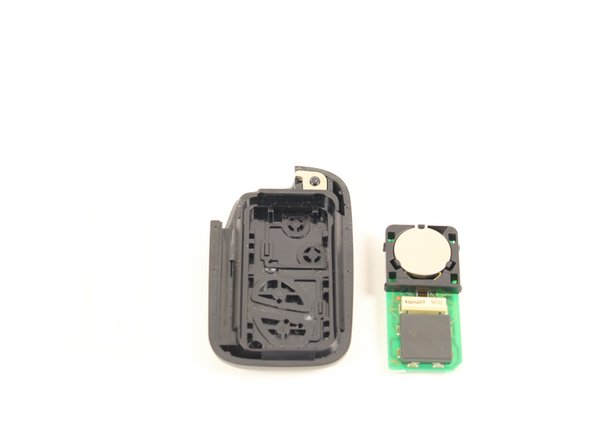

    • Remove the motherboard and battery to access the buttons.

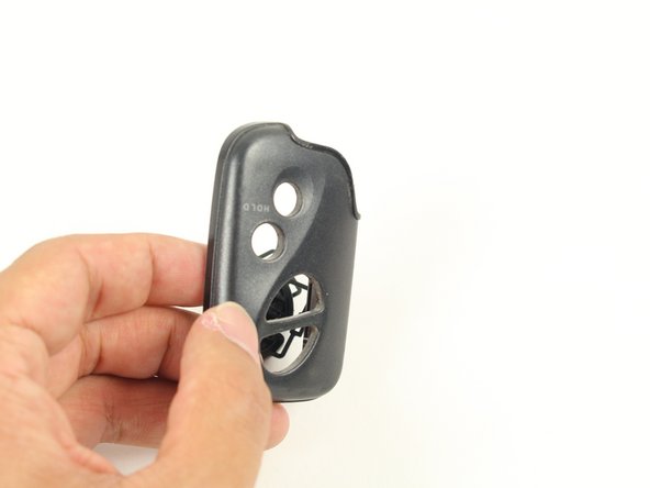

    • Rotate the front plate, the broken buttons should fall out with ease.
    • Replace the broken buttons as necessary.
