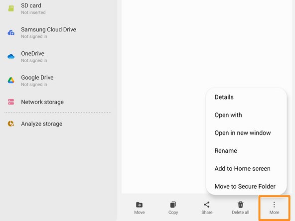

    • If your app didn't show up on the "Installation files" tab, follow the next two steps to rename the file.
    • Navigate to the "Downloads" tab on the left side of the screen.
    • Long press the download file until an orange checkmark appears to the left of it.
    • Navigate to the bottom of the screen and select the "More" option.
  4. How to Calibrate an Optical Fingerprint Sensor: crwdns2935265:04crwdnd2935265:01crwdnd2935265:03crwdne2935265:0 How to Calibrate an Optical Fingerprint Sensor: crwdns2935265:04crwdnd2935265:02crwdnd2935265:03crwdne2935265:0 How to Calibrate an Optical Fingerprint Sensor: crwdns2935265:04crwdnd2935265:03crwdnd2935265:03crwdne2935265:0
    • Select the "Rename" option.
    • Delete the .jar at the end of the app's name.
    • Your file should now appear in the "Installation files" tab.

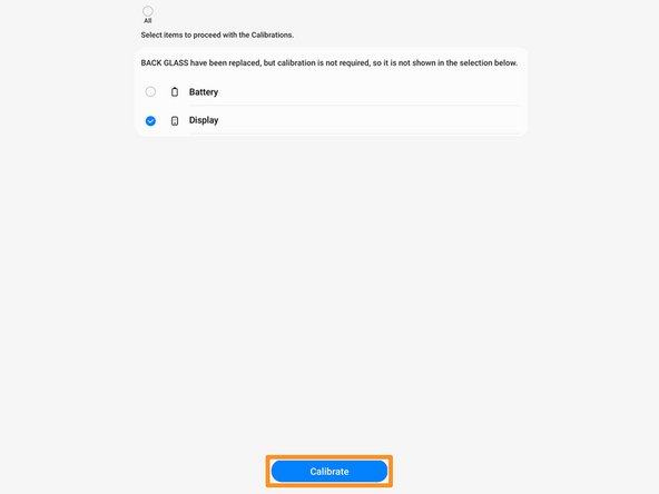

  7. How to Calibrate an Optical Fingerprint Sensor, Select the procedure: crwdns2935265:07crwdnd2935265:01crwdnd2935265:03crwdne2935265:0 How to Calibrate an Optical Fingerprint Sensor, Select the procedure: crwdns2935265:07crwdnd2935265:02crwdnd2935265:03crwdne2935265:0 How to Calibrate an Optical Fingerprint Sensor, Select the procedure: crwdns2935265:07crwdnd2935265:03crwdnd2935265:03crwdne2935265:0
    • Select the "Display" icon.
    • Select "Continue" at the bottom of the screen.
    • If you want to perform a battery cycle reset instead, follow this guide.
    • Select "Start" to begin the fingerprint sensor calibration.

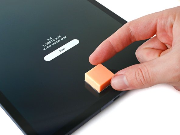

  9. How to Calibrate an Optical Fingerprint Sensor, Apply the white box: crwdns2935265:09crwdnd2935265:01crwdnd2935265:03crwdne2935265:0 How to Calibrate an Optical Fingerprint Sensor, Apply the white box: crwdns2935265:09crwdnd2935265:02crwdnd2935265:03crwdne2935265:0 How to Calibrate an Optical Fingerprint Sensor, Apply the white box: crwdns2935265:09crwdnd2935265:03crwdnd2935265:03crwdne2935265:0
    • Place the white box over the outline near the bottom of the screen.
    • Cover the outline with the side on the box that matches the pattern.
    • Make sure the white box completely covers the outline. Deviations could result in a "Fail" result or an inaccurate calibration.
  10. How to Calibrate an Optical Fingerprint Sensor: crwdns2935265:010crwdnd2935265:01crwdnd2935265:01crwdne2935265:0
    • Use your finger to press down on the white box.
    • While pressing down, use your other hand to select the "Next" icon near the top of the screen.
    • Continue pressing until the "Calibrating" disappears.

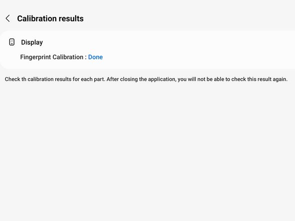

    • Continue pressing until "Done" appears at the top of the screen.

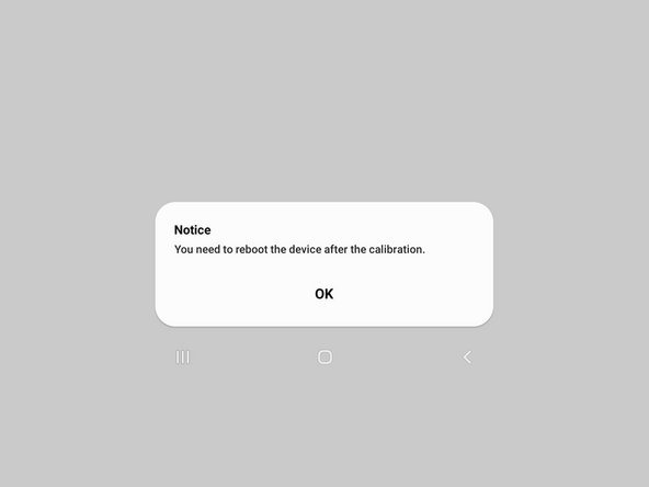

    • You may need to reset your device for the calibration to apply.
Your optical fingerprint sensor is calibrated and ready for use.
If the calibration fails for any reason, repeat the calibration procedure.
