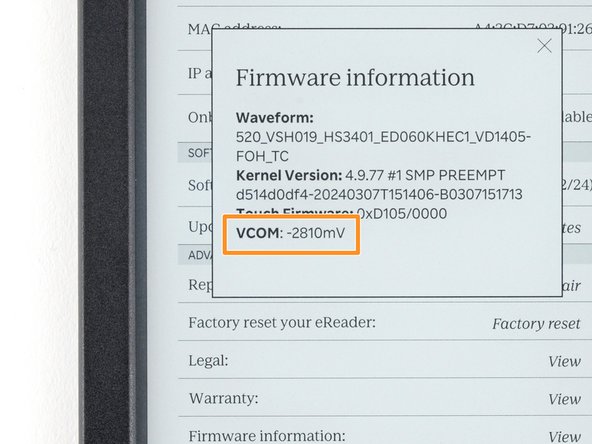

  3. How to Calibrate a Kobo eReader Display, Locate the stored VCOM number: crwdns2935265:03crwdnd2935265:01crwdnd2935265:02crwdne2935265:0 How to Calibrate a Kobo eReader Display, Locate the stored VCOM number: crwdns2935265:03crwdnd2935265:02crwdnd2935265:02crwdne2935265:0
    • Find the row titled Firmware information and select View.
    • The VCOM number will be listed on the popup. Compare it to the VCOM number for your screen.
    • If your VCOM numbers match, your screen is already calibrated—you're done! If the numbers don't match, follow the next three steps to change the VCOM number.

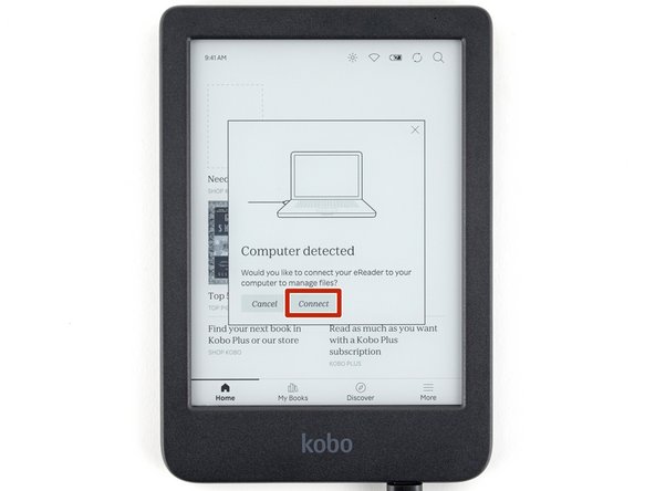

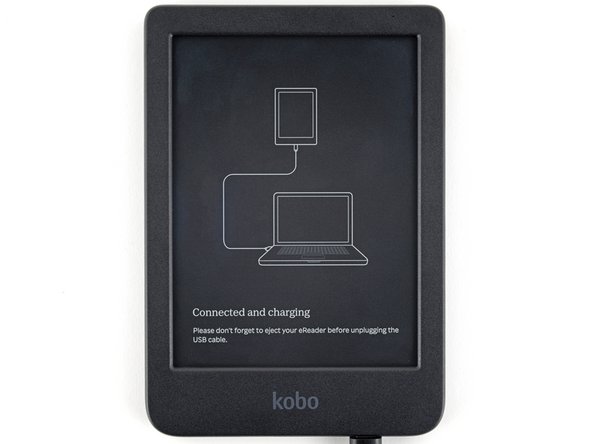

  4. How to Calibrate a Kobo eReader Display, Connect your device to a computer: crwdns2935265:04crwdnd2935265:01crwdnd2935265:03crwdne2935265:0 How to Calibrate a Kobo eReader Display, Connect your device to a computer: crwdns2935265:04crwdnd2935265:02crwdnd2935265:03crwdne2935265:0 How to Calibrate a Kobo eReader Display, Connect your device to a computer: crwdns2935265:04crwdnd2935265:03crwdnd2935265:03crwdne2935265:0
    • Plug your eReader into a computer.
    • You'll be prompted on the eReader that a computer is detected. Select Connect.
    • While the eReader is connected, you can't use it.
    • If you're having trouble connecting to your computer, click here for troubleshooting information.

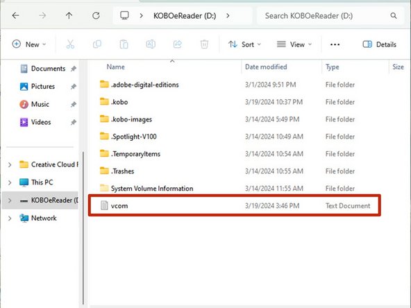

  5. How to Calibrate a Kobo eReader Display, Change the VCOM number: crwdns2935265:05crwdnd2935265:01crwdnd2935265:03crwdne2935265:0 How to Calibrate a Kobo eReader Display, Change the VCOM number: crwdns2935265:05crwdnd2935265:02crwdnd2935265:03crwdne2935265:0 How to Calibrate a Kobo eReader Display, Change the VCOM number: crwdns2935265:05crwdnd2935265:03crwdnd2935265:03crwdne2935265:0
    • On your computer, use a text editor to create a .txt file named vcom with only the desired VCOM number (including the negative symbol and the x1000 multiplication).
    • For example, if the VCOM number on the replacement screen is -2.89, the file should say exactly -2890.

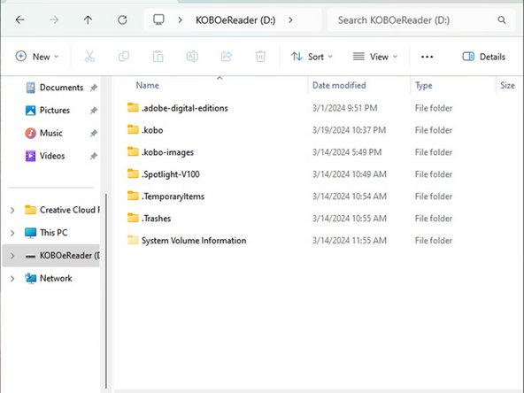

    • Find the drive called KOBOeReader and open it.
    • Move the vcom file into the drive.

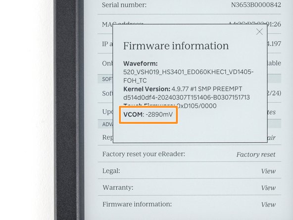

    • On your computer, eject the eReader.
    • Once the device successfully ejects, you'll be prompted to update the VCOM number. Select OK to update the number and restart the eReader.
    • If you don't get prompted, repeat the previous step to ensure your file was formatted and named properly.
    • Navigate back to the Firmware information page and check if your VCOM number has updated.
    • If your VCOM number is updated, you're done! If not, double check each step in this guide to confirm the procedure was done properly.
    • The updated VCOM value might not match the number you entered to the exact digit. As long as it's close, it's fine!
