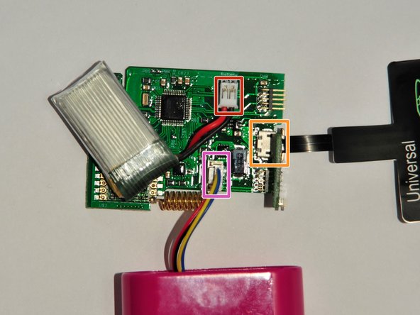

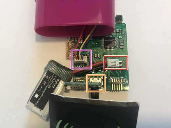

  3. How to Assemble Sigrow Soil Pro Mini, Connect parts to the PCB: crwdns2935265:03crwdnd2935265:01crwdnd2935265:03crwdne2935265:0 How to Assemble Sigrow Soil Pro Mini, Connect parts to the PCB: crwdns2935265:03crwdnd2935265:02crwdnd2935265:03crwdne2935265:0 How to Assemble Sigrow Soil Pro Mini, Connect parts to the PCB: crwdns2935265:03crwdnd2935265:03crwdnd2935265:03crwdne2935265:0
    • The soil sensor, battery and wireless charger all need to be connected to the PCB.
    • Battery
    • Make sure to connect the red wire to the plus (+) side as marked on the PCB. In this photo, the positive side is on the left.
    • Wireless charger
    • Soil sensor
    • When connecting the soil sensor and the PCB, you should hear a *click*.

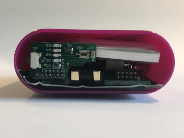

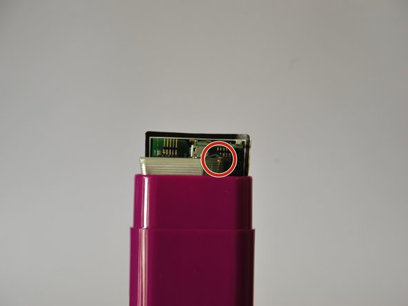

  4. How to Assemble Sigrow Soil Pro Mini, Insert the PCB into the case: crwdns2935265:04crwdnd2935265:01crwdnd2935265:03crwdne2935265:0 How to Assemble Sigrow Soil Pro Mini, Insert the PCB into the case: crwdns2935265:04crwdnd2935265:02crwdnd2935265:03crwdne2935265:0 How to Assemble Sigrow Soil Pro Mini, Insert the PCB into the case: crwdns2935265:04crwdnd2935265:03crwdnd2935265:03crwdne2935265:0
    • The PCB and the wireless charger are inserted into the deep pocket of the soil sensor.
    • Make sure that the Wireless Charger logo is facing towards the outside of the case.
    • Assembly is easiest when the PCB is inserted at a slight angle.
    • Push the wireless charged in behind the PCB.
    • The PCB and wireless charger should be at the same height, but not inserted all the way.

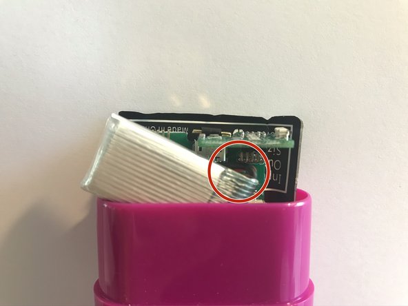

  5. How to Assemble Sigrow Soil Pro Mini, Insert the battery: crwdns2935265:05crwdnd2935265:01crwdnd2935265:03crwdne2935265:0 How to Assemble Sigrow Soil Pro Mini, Insert the battery: crwdns2935265:05crwdnd2935265:02crwdnd2935265:03crwdne2935265:0 How to Assemble Sigrow Soil Pro Mini, Insert the battery: crwdns2935265:05crwdnd2935265:03crwdnd2935265:03crwdne2935265:0
    • The battery should be placed in front of the PCB. This is easiest when diagonally inserted.
    • The battery wires are in the upper righthand corner.

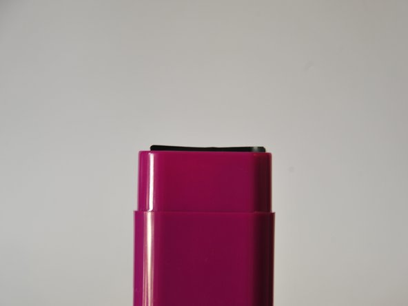

  6. How to Assemble Sigrow Soil Pro Mini, Complete assembly: crwdns2935265:06crwdnd2935265:01crwdnd2935265:03crwdne2935265:0 How to Assemble Sigrow Soil Pro Mini, Complete assembly: crwdns2935265:06crwdnd2935265:02crwdnd2935265:03crwdne2935265:0 How to Assemble Sigrow Soil Pro Mini, Complete assembly: crwdns2935265:06crwdnd2935265:03crwdnd2935265:03crwdne2935265:0
    • The components can now be pressed in all the way.
    • The PCB must be below the edge of the soil sensor. The wireless charger is allowed to stick out a little bit.
