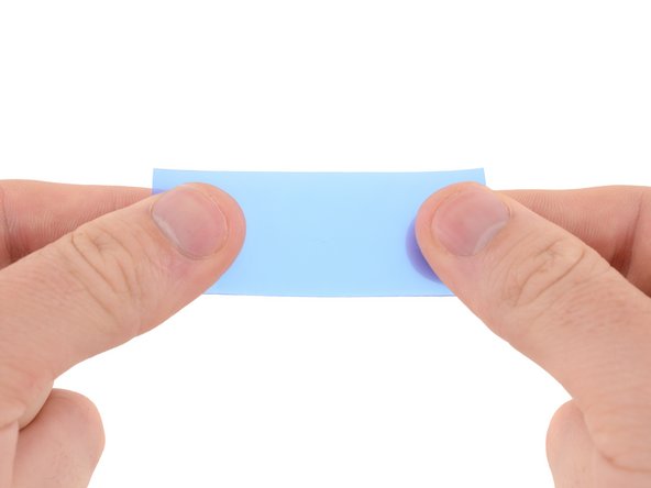

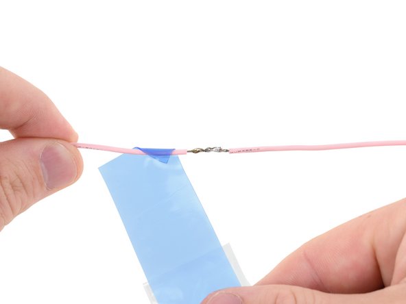

  2. How to Apply Silicone Electrical Tape, Snip off a piece of tape: crwdns2935265:02crwdnd2935265:01crwdnd2935265:01crwdne2935265:0
    $3.99

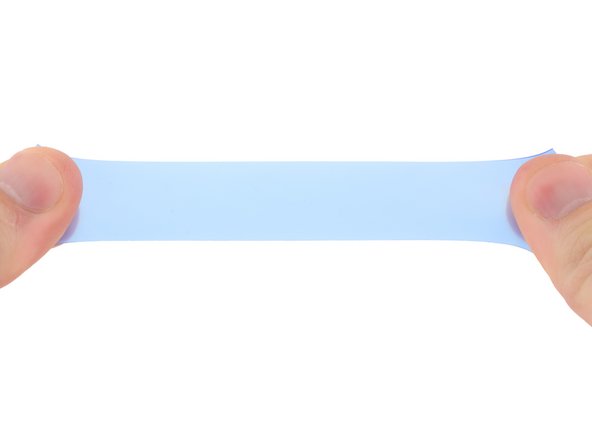

    • Use scissors to cut off a small strip of silicone electrical tape.
    • Silicone electrical tape stretches several times its original length, so a short strip can cover more wire than you expect.
    • If you don't think you need a whole roll, check out our precut strips for small jobs or splicing on the go!

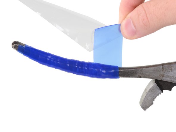

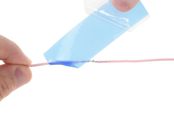

  3. How to Apply Silicone Electrical Tape, Remove part of the liner: crwdns2935265:03crwdnd2935265:01crwdnd2935265:03crwdne2935265:0 How to Apply Silicone Electrical Tape, Remove part of the liner: crwdns2935265:03crwdnd2935265:02crwdnd2935265:03crwdne2935265:0 How to Apply Silicone Electrical Tape, Remove part of the liner: crwdns2935265:03crwdnd2935265:03crwdnd2935265:03crwdne2935265:0
    • Remove an inch or two of the plastic liner before before wrapping the silicone electrical tape.
    • The more the tape is stretched, the stronger and faster it will bond!
  4. How to Apply Silicone Electrical Tape, Apply the tape: crwdns2935265:04crwdnd2935265:01crwdnd2935265:03crwdne2935265:0 How to Apply Silicone Electrical Tape, Apply the tape: crwdns2935265:04crwdnd2935265:02crwdnd2935265:03crwdne2935265:0 How to Apply Silicone Electrical Tape, Apply the tape: crwdns2935265:04crwdnd2935265:03crwdnd2935265:03crwdne2935265:0

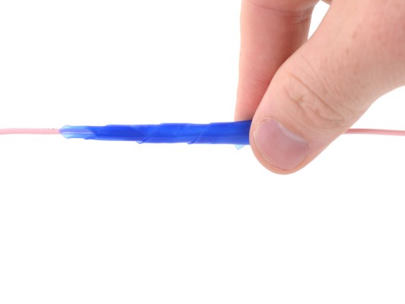

    • Wrap a corner of the silicone electrical tape to one side of the exposed section of wire.
    • The wrap should extend an inch past the exposed portion of wire on both sides to ensure complete insulation.
    • Continue to wrap the tape around the wire while stretching the tape and removing the liner.
    • Overlap each layer by approximately 2/3 of the previous wrap for best results.
  5. How to Apply Silicone Electrical Tape, Finish the application: crwdns2935265:05crwdnd2935265:01crwdnd2935265:02crwdne2935265:0 How to Apply Silicone Electrical Tape, Finish the application: crwdns2935265:05crwdnd2935265:02crwdnd2935265:02crwdne2935265:0
    • Finish the application by completely overlapping the final wrap back on itself.
    • Press down firmly on the end to set the silicone electrical tape.

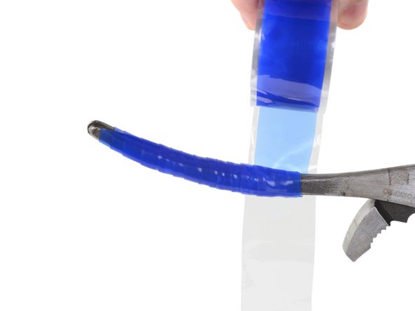

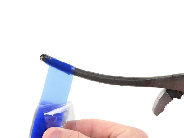

  6. How to Apply Silicone Electrical Tape, How to create a grippy surface: crwdns2935265:06crwdnd2935265:01crwdnd2935265:03crwdne2935265:0 How to Apply Silicone Electrical Tape, How to create a grippy surface: crwdns2935265:06crwdnd2935265:02crwdnd2935265:03crwdne2935265:0 How to Apply Silicone Electrical Tape, How to create a grippy surface: crwdns2935265:06crwdnd2935265:03crwdnd2935265:03crwdne2935265:0
    • The next three steps show how to use the tape to create a grippy surface.
    • Clean the surface and your hands before applying the silicone electrical tape.
    • Press the end of the silicone electrical tape firmly on the handle.
    • While stretching the tape, completely overlap the first wrap on itself to ensure a good bond.
    • Continue to wrap the tape around the handle while stretching the tape and removing the liner.
  7. How to Apply Silicone Electrical Tape: crwdns2935265:07crwdnd2935265:01crwdnd2935265:02crwdne2935265:0 How to Apply Silicone Electrical Tape: crwdns2935265:07crwdnd2935265:02crwdnd2935265:02crwdne2935265:0
    • Use scissors to cut the silicone electrical tape, leaving a small strip to finish wrapping the handle.
    • Remove the liner completely.

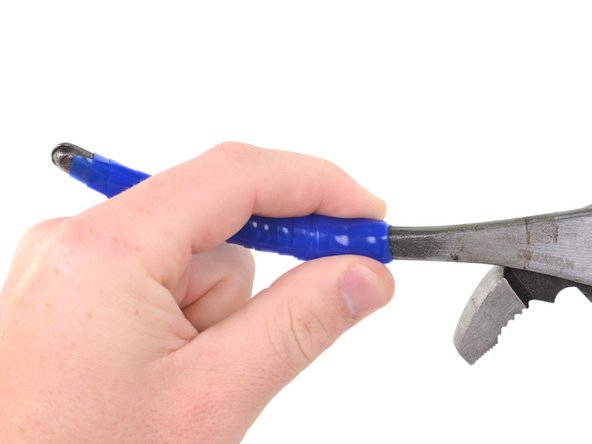

  8. How to Apply Silicone Electrical Tape, Finish the wrap: crwdns2935265:08crwdnd2935265:01crwdnd2935265:03crwdne2935265:0 How to Apply Silicone Electrical Tape, Finish the wrap: crwdns2935265:08crwdnd2935265:02crwdnd2935265:03crwdne2935265:0 How to Apply Silicone Electrical Tape, Finish the wrap: crwdns2935265:08crwdnd2935265:03crwdnd2935265:03crwdne2935265:0
