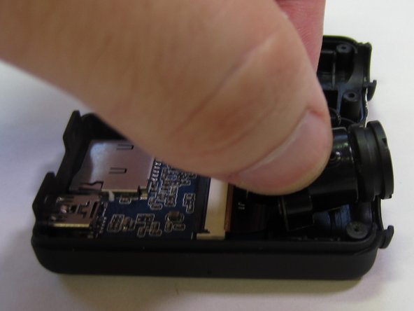

  3. How to Adjust the Mobius ActionCam Camera Focus: crwdns2935265:03crwdnd2935265:01crwdnd2935265:02crwdne2935265:0 How to Adjust the Mobius ActionCam Camera Focus: crwdns2935265:03crwdnd2935265:02crwdnd2935265:02crwdne2935265:0
    • Locate the camera module.
    • Grab the sides of the camera module and gently pull to free it from the case.
    • Be gentle when handling the camera module to avoid damaging the fragile ribbon cable attached to it.

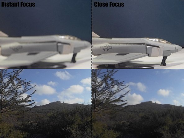

  4. How to Adjust the Mobius ActionCam Camera Focus: crwdns2935265:04crwdnd2935265:01crwdnd2935265:01crwdne2935265:0
    • Use a 0.9mm hex key or driver to loosen the set screw fastened into the side of the camera module.
    • Loosen the screw until it turns freely. Do not fully remove the set screw.
  5. How to Adjust the Mobius ActionCam Camera Focus: crwdns2935265:05crwdnd2935265:01crwdnd2935265:02crwdne2935265:0 How to Adjust the Mobius ActionCam Camera Focus: crwdns2935265:05crwdnd2935265:02crwdnd2935265:02crwdne2935265:0
    • Grab the side of the lens and gently turn to adjust the focus.
    • While facing the back of the camera module, turning the lens all the way clockwise will bring objects 4"-6" away into focus. Turning the lens all the way counterclockwise will bring distant objects into focus.
    • The lens has about a half turn of travel.
