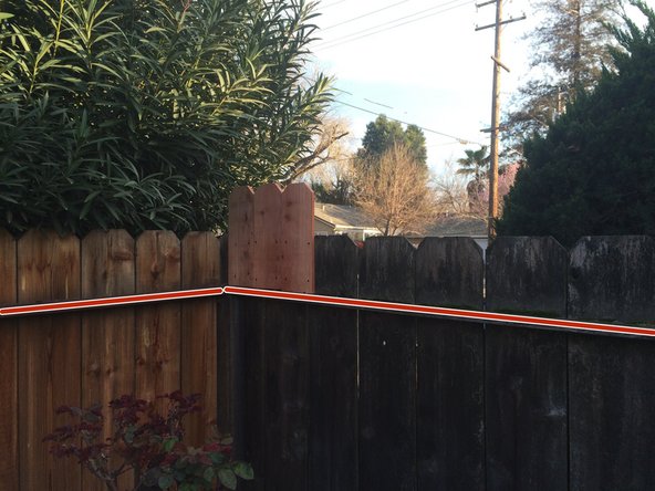

    • After buying my home, I realized that anybody could walk by my back fence and look right into my backyard. I'm sure I'm not the only one who feels a little uneasy about such a lack of privacy.

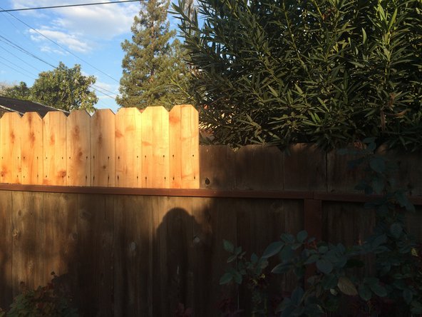

    • To add privacy and provide stability to an older fence, I headed to my local hardware store and bought a few fence boards. The boards pictured cost $3.85 a board and, depending on how tall you need your boards cut, one fence board provides approximately three privacy boards.

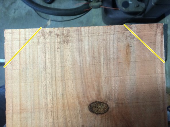

    • Once I purchased my boards, it was time to cut them. I used a miter saw, but a hand saw works just fine. In order to find the length of your privacy boards, measure from the top rail of your existing fence to the future height that you would like to extend your fence.
  4. How to Add Privacy to a Wood Fence: crwdns2935265:04crwdnd2935265:01crwdnd2935265:02crwdne2935265:0 How to Add Privacy to a Wood Fence: crwdns2935265:04crwdnd2935265:02crwdnd2935265:02crwdne2935265:0
    • Once you have your measurement, mark your board (measure twice, cut once) and then make your cut.
  5. How to Add Privacy to a Wood Fence: crwdns2935265:05crwdnd2935265:01crwdnd2935265:03crwdne2935265:0 How to Add Privacy to a Wood Fence: crwdns2935265:05crwdnd2935265:02crwdnd2935265:03crwdne2935265:0 How to Add Privacy to a Wood Fence: crwdns2935265:05crwdnd2935265:03crwdnd2935265:03crwdne2935265:0
    • After you mark the board in order to notch it, move your miter saw to a 45 degree angle to make the first cut.
    • Then flip the board and shift the saw to make the second cut.
