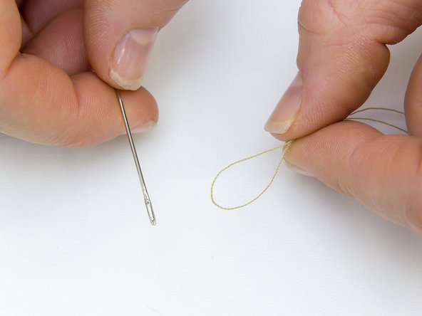

    • Cut approx. 80 cm of thread from the spool.
  2. How do I sew a button onto my Vaude shirt?: crwdns2935265:02crwdnd2935265:01crwdnd2935265:01crwdne2935265:0
    • Double the thread.
  3. How do I sew a button onto my Vaude shirt?: crwdns2935265:03crwdnd2935265:01crwdnd2935265:03crwdne2935265:0 How do I sew a button onto my Vaude shirt?: crwdns2935265:03crwdnd2935265:02crwdnd2935265:03crwdne2935265:0 How do I sew a button onto my Vaude shirt?: crwdns2935265:03crwdnd2935265:03crwdnd2935265:03crwdne2935265:0

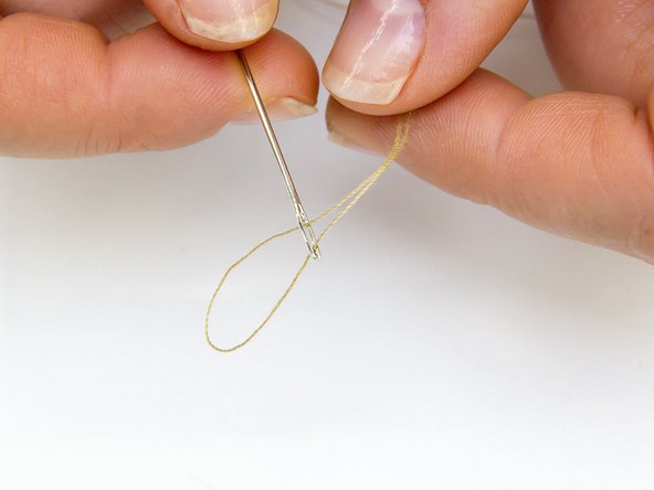

    • Take the looped end of the thread and thread it through the eye of the needle.
  4. How do I sew a button onto my Vaude shirt?: crwdns2935265:04crwdnd2935265:01crwdnd2935265:01crwdne2935265:0
    • Pull the loop through about 20 cm.
