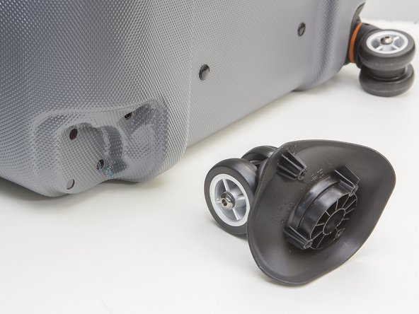

How do I replace the wheels on my Melbourne trolley?
  1. How do I replace the wheels on my Melbourne trolley?, Wheels: crwdns2935265:01crwdnd2935265:01crwdnd2935265:03crwdne2935265:0 How do I replace the wheels on my Melbourne trolley?, Wheels: crwdns2935265:01crwdnd2935265:02crwdnd2935265:03crwdne2935265:0 How do I replace the wheels on my Melbourne trolley?, Wheels: crwdns2935265:01crwdnd2935265:03crwdnd2935265:03crwdne2935265:0
    • Open the trolley and unzip the lining.
  2. How do I replace the wheels on my Melbourne trolley?: crwdns2935265:02crwdnd2935265:01crwdnd2935265:02crwdne2935265:0 How do I replace the wheels on my Melbourne trolley?: crwdns2935265:02crwdnd2935265:02crwdnd2935265:02crwdne2935265:0
    • Unscrew the 4 screws with a Phillips screwdriver PH2 die 4.
  3. How do I replace the wheels on my Melbourne trolley?: crwdns2935265:03crwdnd2935265:01crwdnd2935265:02crwdne2935265:0 How do I replace the wheels on my Melbourne trolley?: crwdns2935265:03crwdnd2935265:02crwdnd2935265:02crwdne2935265:0
    • Remove the wheels from the wheelhouse.
Follow the instructions in reverse order to finish the repair.
