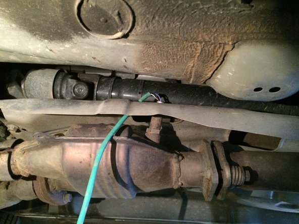

    • Collect Supplies.
    • Make sure the new Exhaust Front Cover is free of stickers, oil, or residues.

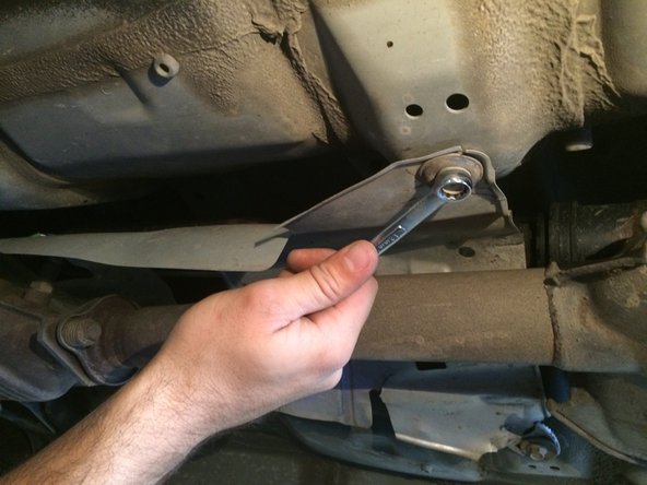

  3. How To Replace A  Subaru Outback Exhaust Front Cover: crwdns2935265:03crwdnd2935265:01crwdnd2935265:01crwdne2935265:0
    • Put on safety glasses. Be sure to leave them on until the fix is complete.
    • Do not touch any exhaust components until you have verified that there is no danger of getting burned.
    • Laying on your back, maneuver yourself underneath the driver or passenger side of the car carrying the 12mm combination wrench. Locate yourself about even with the back of the front door.

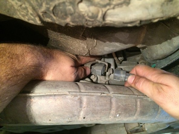

    • Unplug the rear oxygen sensor connector and carefully route the wires through the Exhaust Front Cover so they are no longer passing through it.

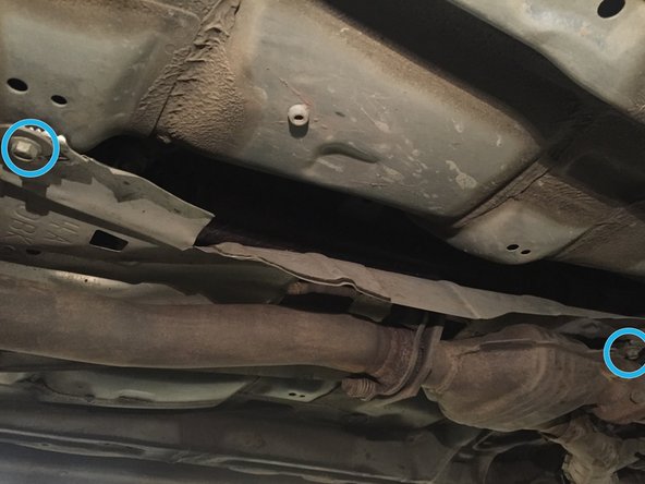

    • Locate the four mounting bolts for the Exhaust Front Cover.
    • Remove the bolts by turning them counterclockwise using the 12mm combination wrench.
