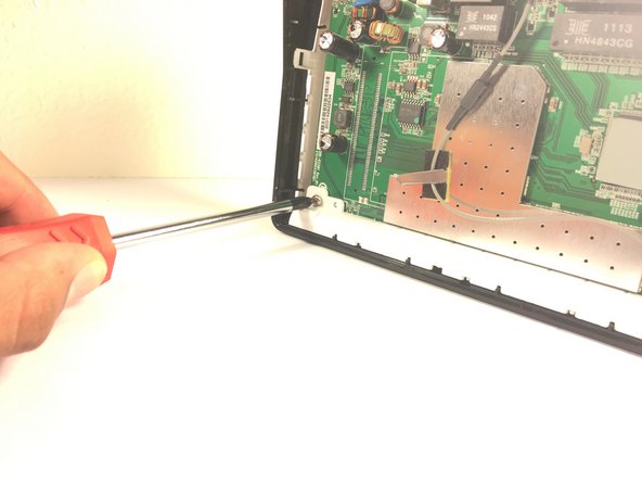

  4. How To Repair An Overheating D-LINK DIR-655 Wireless Router: crwdns2935265:04crwdnd2935265:01crwdnd2935265:01crwdne2935265:0
    • Gently pry the top of the case from the sides and bottom of the router.
    • After freeing the top, remove it and set it aside.
  5. How To Repair An Overheating D-LINK DIR-655 Wireless Router: crwdns2935265:05crwdnd2935265:01crwdnd2935265:02crwdne2935265:0 How To Repair An Overheating D-LINK DIR-655 Wireless Router: crwdns2935265:05crwdnd2935265:02crwdnd2935265:02crwdne2935265:0
    • With your Phillips screwdriver, remove both screws by rotating in a counter-clockwise direction.
  6. How To Repair An Overheating D-LINK DIR-655 Wireless Router: crwdns2935265:06crwdnd2935265:01crwdnd2935265:01crwdne2935265:0
    • After removing the screws, lift the white LED cover up and off of the circuit board.
  7. How To Repair An Overheating D-LINK DIR-655 Wireless Router: crwdns2935265:07crwdnd2935265:01crwdnd2935265:03crwdne2935265:0 How To Repair An Overheating D-LINK DIR-655 Wireless Router: crwdns2935265:07crwdnd2935265:02crwdnd2935265:03crwdne2935265:0 How To Repair An Overheating D-LINK DIR-655 Wireless Router: crwdns2935265:07crwdnd2935265:03crwdnd2935265:03crwdne2935265:0
    • Next, bend up the clip holding down the middle antenna wire.
    • Gently, unhook the wire and move it out of the way.
  8. How To Repair An Overheating D-LINK DIR-655 Wireless Router: crwdns2935265:08crwdnd2935265:01crwdnd2935265:01crwdne2935265:0
    • With the wire out of the way, separate the circuit board from the bottom assembly.
    • Be sure not to pinch or bend the antenna wire when you lift the circuit board.
  9. How To Repair An Overheating D-LINK DIR-655 Wireless Router: crwdns2935265:09crwdnd2935265:01crwdnd2935265:01crwdne2935265:0
    • Wipe away any dust from the the vents to ensure proper airflow.
