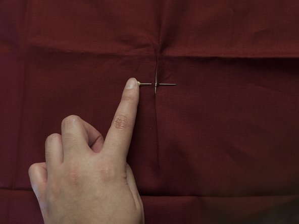

    • Apply a thin layer of the anti-fray glue to both edges of the rip. Let it dry completely.
  2. How To Repair A Couch Cushion: crwdns2935265:02crwdnd2935265:01crwdnd2935265:01crwdne2935265:0
    • Fold the edges of the fabric over to make a clean edge and hide any fraying.
    • Crease the fold with your fingers.
  3. How To Repair A Couch Cushion: crwdns2935265:03crwdnd2935265:01crwdnd2935265:01crwdne2935265:0
    • Cut the upholstery thread to a length appropriate for the size of your rip.
    • The thread should match the color of the fabric as closely as possible.
    • Thread the needle and tie a double knot at the end.
  4. How To Repair A Couch Cushion: crwdns2935265:04crwdnd2935265:01crwdnd2935265:02crwdne2935265:0 How To Repair A Couch Cushion: crwdns2935265:04crwdnd2935265:02crwdnd2935265:02crwdne2935265:0
    • Hold the two edges of the rip together
    • Begin sewing ¾ of an inch from where the rip begins.
    • You might want to use a pin to hold the edges together while you sew
  5. How To Repair A Couch Cushion: crwdns2935265:05crwdnd2935265:01crwdnd2935265:03crwdne2935265:0 How To Repair A Couch Cushion: crwdns2935265:05crwdnd2935265:02crwdnd2935265:03crwdne2935265:0 How To Repair A Couch Cushion: crwdns2935265:05crwdnd2935265:03crwdnd2935265:03crwdne2935265:0
    • Continue sewing until you are past the rip. Knot and cut the excess thread.
