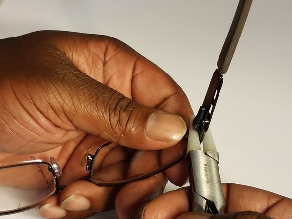

      • Place frame on a flat surface for evaluation
    2. How To Realign Metal Frames: crwdns2935265:02crwdnd2935265:01crwdnd2935265:01crwdne2935265:0
      • Warning do not bend ear templates If the templates are cracked.
      • Place scotch tape on lens to prevent them from becoming scratched.
    3. How To Realign Metal Frames: crwdns2935265:03crwdnd2935265:01crwdnd2935265:02crwdne2935265:0 How To Realign Metal Frames: crwdns2935265:03crwdnd2935265:02crwdnd2935265:02crwdne2935265:0
      • Place eyewear pliers in between the template and the front of the frame. Slowly bend template towards the lens as much as needed to fit snugly on head.
    4. How To Realign Metal Frames: crwdns2935265:04crwdnd2935265:01crwdnd2935265:02crwdne2935265:0 How To Realign Metal Frames: crwdns2935265:04crwdnd2935265:02crwdnd2935265:02crwdne2935265:0
      • Make sure both ear templates are even.
      • Do not bend the ear templates if they are cracked.
