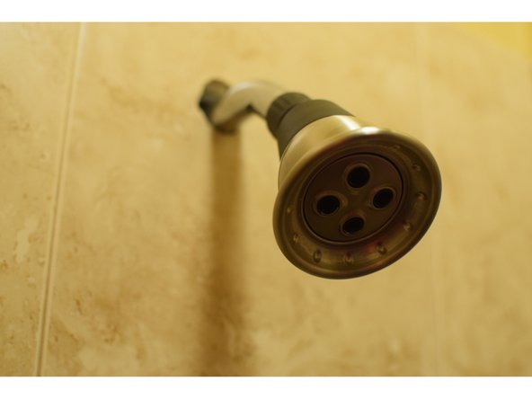

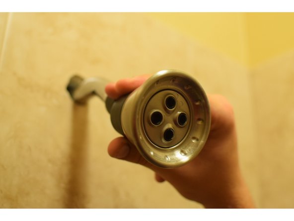

    • First, you are going to remove the current shower head from the shower arm.
    • Twist the shower head counter clock-wise until it is completely removed from arm.
    • You will now see the existing older model ball adapter, which is not universal for modern shower heads.

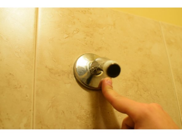

    • Some showers will have a face plate connected to the wall.
    • In this case, use a chisel to gently pry the face plate from the wall.
