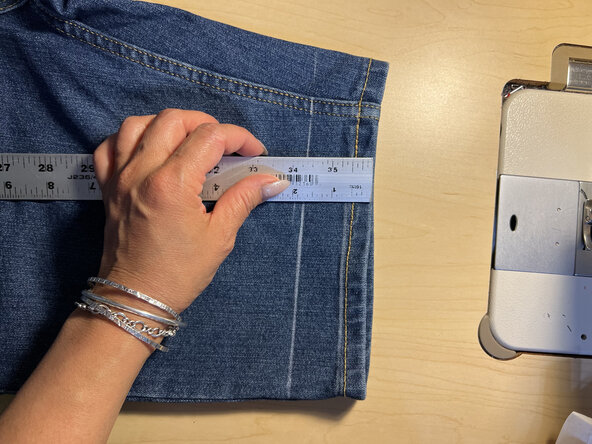

How To Hem Jean Shorts
  1. How To Hem Jean Shorts, How To Hem Jean Shorts: crwdns2935265:01crwdnd2935265:01crwdnd2935265:01crwdne2935265:0
    • Use a ruler to measure and mark your preferred length of the shorts with fabric chalk.
    • Measure each side carefully and make sure both legs are marked evenly.

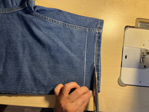

  2. How To Hem Jean Shorts: crwdns2935265:02crwdnd2935265:01crwdnd2935265:01crwdne2935265:0
    • Mark an additional line 1 inch below your chosen length to allow room for folding the hem.
    • Use sharp fabric scissors to cut across each leg along the lower chalk line.

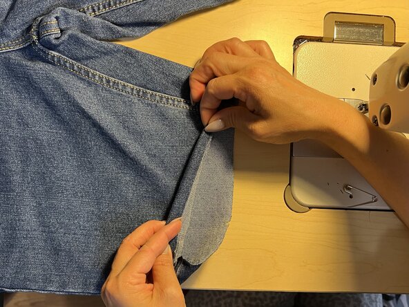

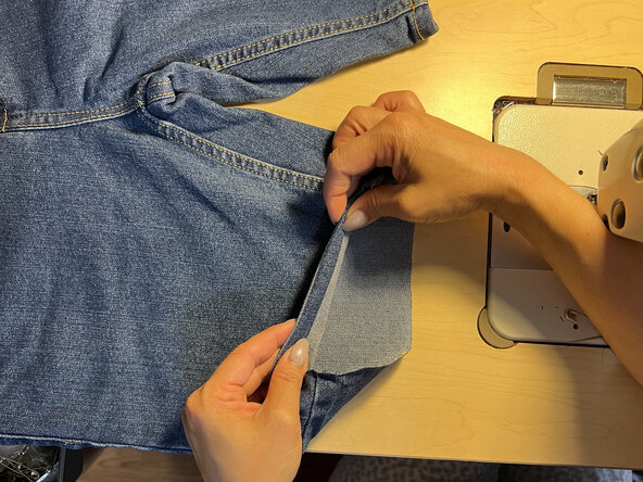

  3. How To Hem Jean Shorts: crwdns2935265:03crwdnd2935265:01crwdnd2935265:03crwdne2935265:0 How To Hem Jean Shorts: crwdns2935265:03crwdnd2935265:02crwdnd2935265:03crwdne2935265:0 How To Hem Jean Shorts: crwdns2935265:03crwdnd2935265:03crwdnd2935265:03crwdne2935265:0
    • Fold the bottom edge of each leg up 1/2 inch, then fold it again to tuck the raw edge inside.
    • Pin the fold in place all the way around the leg to keep it secure.
    • Double check that both hems are even before moving to the next step.

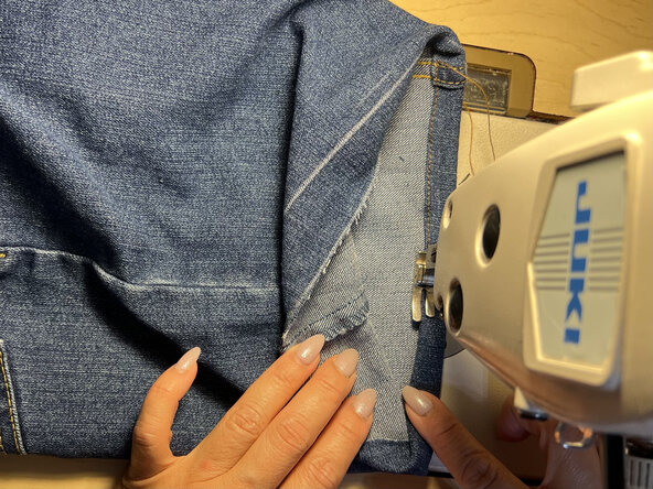

  4. How To Hem Jean Shorts: crwdns2935265:04crwdnd2935265:01crwdnd2935265:01crwdne2935265:0
    • Place the folded edge of one leg under the presser foot of the sewing machine.
    • Lower the presser foot to the fabric before you begin sewing.

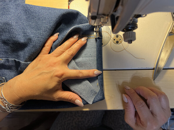

  5. How To Hem Jean Shorts: crwdns2935265:05crwdnd2935265:01crwdnd2935265:01crwdne2935265:0
    • Carefully sew along the folded edge, keeping the stitch even and close to the inside edge of the fold.
    • Backstitch at the beginning and end to secure the seam.
    • Repeat the same process on the other leg.

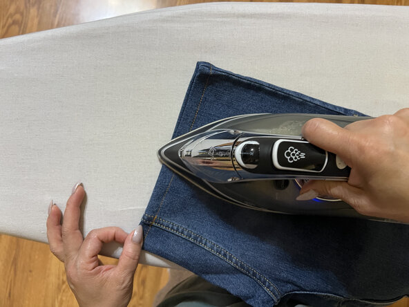

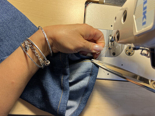

  6. How To Hem Jean Shorts: crwdns2935265:06crwdnd2935265:01crwdnd2935265:02crwdne2935265:0 How To Hem Jean Shorts: crwdns2935265:06crwdnd2935265:02crwdnd2935265:02crwdne2935265:0
    • Once the hems are sewn, trim off any loose threads.
    • Use an iron to press the hem flat for a clean finish.
