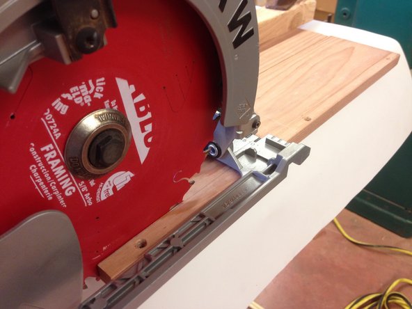

    • Measure the exact distance between the outside edge of the circular saw and its blade.
    • That would be the distance you need between the pencil line and the wooden piece.
  4. How To Fix Overused Screw Holes In Book Shelves: crwdns2935265:04crwdnd2935265:01crwdnd2935265:01crwdne2935265:0
    • Clamp the wooden piece on your sideboard; one clamp for each side.
    • You can use any object which is straight and at least 4 inches longer than the sideboard's width.
  5. How To Fix Overused Screw Holes In Book Shelves: crwdns2935265:05crwdnd2935265:01crwdnd2935265:01crwdne2935265:0
    • Put on your safety glasses.
  6. How To Fix Overused Screw Holes In Book Shelves: crwdns2935265:06crwdnd2935265:01crwdnd2935265:02crwdne2935265:0 How To Fix Overused Screw Holes In Book Shelves: crwdns2935265:06crwdnd2935265:02crwdnd2935265:02crwdne2935265:0
    • Cut along the wooden piece. Gently apply pressure on the corner for a clean straight cut.
