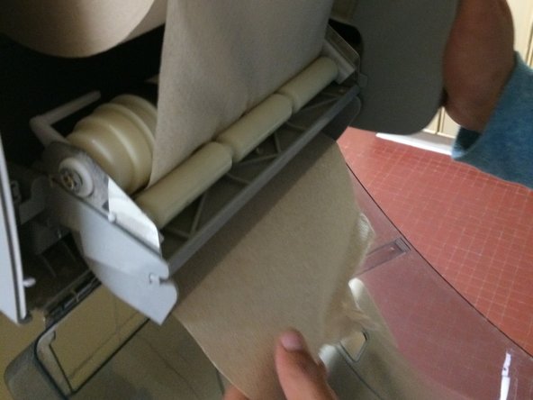

    • Open the paper-towel dispenser's cover using your Philips head screwdriver and turn it counter-clockwise.
    • Some paper-towel dispensers require a key to unlock them. The lock is generally located on the top of the paper-towel dispenser.
  2. How To Fix A Paper Towel Dispenser: crwdns2935265:02crwdnd2935265:01crwdnd2935265:01crwdne2935265:0
    • Look for jams. Check every space inside the paper-towel dispenser for wads of paper towels. Remove any stray bits of paper towel that you find.
  3. How To Fix A Paper Towel Dispenser: crwdns2935265:03crwdnd2935265:01crwdnd2935265:01crwdne2935265:0
    • Tear off the paper towels just above the rollers.
    • Remove the roll of paper towels. Pull the lever of the paper-towel dispenser a few times to dislodge any remaining paper towels.
  4. How To Fix A Paper Towel Dispenser: crwdns2935265:04crwdnd2935265:01crwdnd2935265:03crwdne2935265:0 How To Fix A Paper Towel Dispenser: crwdns2935265:04crwdnd2935265:02crwdnd2935265:03crwdne2935265:0 How To Fix A Paper Towel Dispenser: crwdns2935265:04crwdnd2935265:03crwdnd2935265:03crwdne2935265:0
    • Replace the roll of paper towels. Make sure the roll is coming over the top towards you. Sometimes the paper towels will still come out of the dispenser if the roll is backward, but will tear off inside the dispenser and cause jams.
    • Push holsters outwards when attempting to put a new roll in.
  5. How To Fix A Paper Towel Dispenser: crwdns2935265:05crwdnd2935265:01crwdnd2935265:03crwdne2935265:0 How To Fix A Paper Towel Dispenser: crwdns2935265:05crwdnd2935265:02crwdnd2935265:03crwdne2935265:0 How To Fix A Paper Towel Dispenser: crwdns2935265:05crwdnd2935265:03crwdnd2935265:03crwdne2935265:0
    • Feed the paper towels through the rollers. Pull the paper-towel dispenser's lever three or four times to make sure the paper is completely fed through.
    • Don't get your fingers caught!
  6. How To Fix A Paper Towel Dispenser: crwdns2935265:06crwdnd2935265:01crwdnd2935265:01crwdne2935265:0
    • Close the paper-towel dispenser's cover. Turn tool clockwise to lock. If there is a key, lock the paper-towel dispenser.
