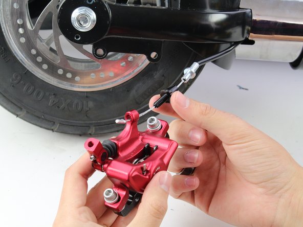

The screws on the brakes are tight, but it's best to use hand tools so the screws don't get stripped.
    1. Hover-1 XLS Brake Replacement, Front Brake: crwdns2935265:01crwdnd2935265:01crwdnd2935265:03crwdne2935265:0 Hover-1 XLS Brake Replacement, Front Brake: crwdns2935265:01crwdnd2935265:02crwdnd2935265:03crwdne2935265:0 Hover-1 XLS Brake Replacement, Front Brake: crwdns2935265:01crwdnd2935265:03crwdnd2935265:03crwdne2935265:0
      • Remove the two, 23 mm Hex #5 screws holding the brake to the bike.
      • Slide the brake mechanism off and turn it upside down to reveal the screw holding the brake wire.
    2. Hover-1 XLS Brake Replacement: crwdns2935265:02crwdnd2935265:01crwdnd2935265:01crwdne2935265:0
      • Remove the one, 14 mm Hex #4 screw pushing down the brake wire to the brake mechanism on the bottom.
    3. Hover-1 XLS Brake Replacement: crwdns2935265:03crwdnd2935265:01crwdnd2935265:02crwdne2935265:0 Hover-1 XLS Brake Replacement: crwdns2935265:03crwdnd2935265:02crwdnd2935265:02crwdne2935265:0
      • Remove the side screw holding the brake wire and mechanism together with your hands.
      • Slide the brake mechanism off from the brake wire.
