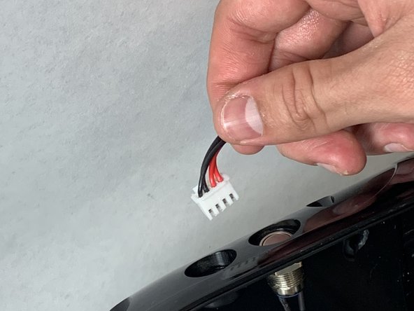

  2. Hover-1 Ultra Charging Port Replacement: crwdns2935265:02crwdnd2935265:01crwdnd2935265:02crwdne2935265:0 Hover-1 Ultra Charging Port Replacement: crwdns2935265:02crwdnd2935265:02crwdnd2935265:02crwdne2935265:0
    • Using your hands or a crescent wrench, begin removing the charging port.
    • Turn the charging port counter-clockwise to release it from the shell.

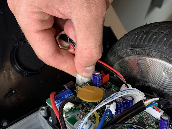

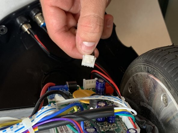

  3. Hover-1 Ultra Charging Port Replacement: crwdns2935265:03crwdnd2935265:01crwdnd2935265:03crwdne2935265:0 Hover-1 Ultra Charging Port Replacement: crwdns2935265:03crwdnd2935265:02crwdnd2935265:03crwdne2935265:0 Hover-1 Ultra Charging Port Replacement: crwdns2935265:03crwdnd2935265:03crwdnd2935265:03crwdne2935265:0
    • Unclip the insulated red and black wires attached to the port from the motherboard
  4. Hover-1 Ultra Charging Port Replacement: crwdns2935265:04crwdnd2935265:01crwdnd2935265:03crwdne2935265:0 Hover-1 Ultra Charging Port Replacement: crwdns2935265:04crwdnd2935265:02crwdnd2935265:03crwdne2935265:0 Hover-1 Ultra Charging Port Replacement: crwdns2935265:04crwdnd2935265:03crwdnd2935265:03crwdne2935265:0
    • Remove the charging port through the assembly.
    • Place new charging port through the assembly.
    • Clip red and black insulated wires into the motherboard.
