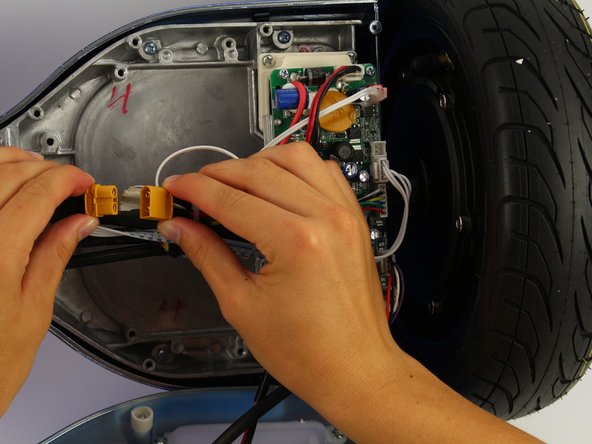

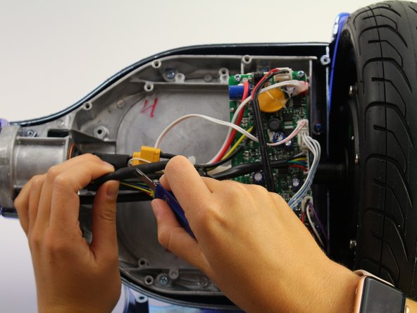

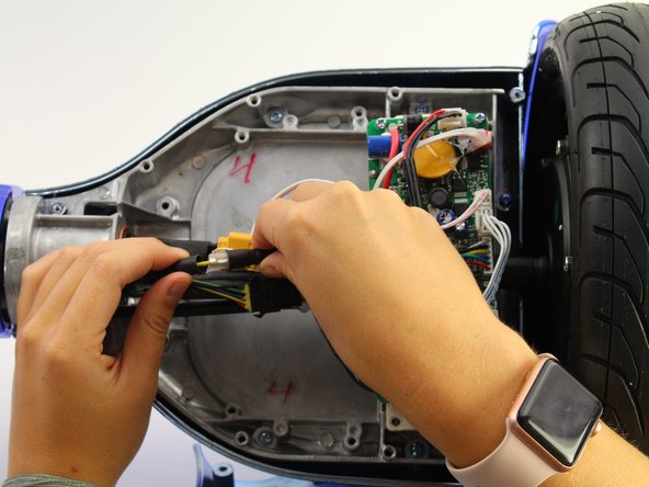

  4. Hover-1 Titan Wheel and Motor Replacement, Wheel and Motor: crwdns2935265:04crwdnd2935265:01crwdnd2935265:02crwdne2935265:0 Hover-1 Titan Wheel and Motor Replacement, Wheel and Motor: crwdns2935265:04crwdnd2935265:02crwdnd2935265:02crwdne2935265:0
    • Unplug the battery by pulling apart the yellow connectors.

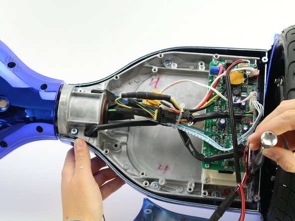

  5. Hover-1 Titan Wheel and Motor Replacement: crwdns2935265:05crwdnd2935265:01crwdnd2935265:02crwdne2935265:0 Hover-1 Titan Wheel and Motor Replacement: crwdns2935265:05crwdnd2935265:02crwdnd2935265:02crwdne2935265:0
    • Use the Phillips #1 screwdriver to remove the four 12mm screws that attach the gyroscope/motherboard to the hoverboard.

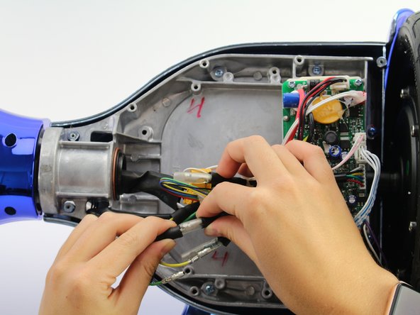

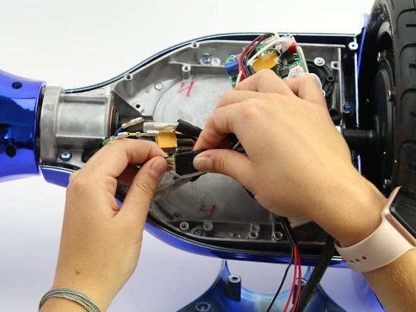

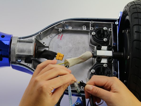

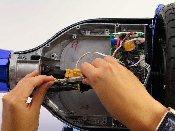

  6. Hover-1 Titan Wheel and Motor Replacement: crwdns2935265:06crwdnd2935265:01crwdnd2935265:03crwdne2935265:0 Hover-1 Titan Wheel and Motor Replacement: crwdns2935265:06crwdnd2935265:02crwdnd2935265:03crwdne2935265:0 Hover-1 Titan Wheel and Motor Replacement: crwdns2935265:06crwdnd2935265:03crwdnd2935265:03crwdne2935265:0
    • Cut the rubber surrounding the yellow wire and pull the rubber apart, exposing the connectors.
  7. Hover-1 Titan Wheel and Motor Replacement: crwdns2935265:07crwdnd2935265:01crwdnd2935265:02crwdne2935265:0 Hover-1 Titan Wheel and Motor Replacement: crwdns2935265:07crwdnd2935265:02crwdnd2935265:02crwdne2935265:0
    • Unplug the yellow wires by gripping the wire close to the connectors and pulling apart.

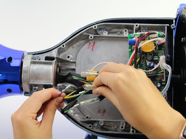

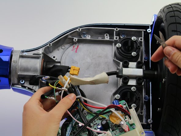

  8. Hover-1 Titan Wheel and Motor Replacement: crwdns2935265:08crwdnd2935265:01crwdnd2935265:03crwdne2935265:0 Hover-1 Titan Wheel and Motor Replacement: crwdns2935265:08crwdnd2935265:02crwdnd2935265:03crwdne2935265:0 Hover-1 Titan Wheel and Motor Replacement: crwdns2935265:08crwdnd2935265:03crwdnd2935265:03crwdne2935265:0
    • Cut the rubber surrounding the green wire and pull the rubber apart, exposing the connectors.
  9. Hover-1 Titan Wheel and Motor Replacement: crwdns2935265:09crwdnd2935265:01crwdnd2935265:02crwdne2935265:0 Hover-1 Titan Wheel and Motor Replacement: crwdns2935265:09crwdnd2935265:02crwdnd2935265:02crwdne2935265:0
    • Unplug the green wires by gripping the wire close to the connectors and pulling apart.

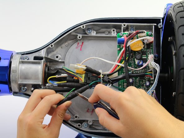

  10. Hover-1 Titan Wheel and Motor Replacement: crwdns2935265:010crwdnd2935265:01crwdnd2935265:03crwdne2935265:0 Hover-1 Titan Wheel and Motor Replacement: crwdns2935265:010crwdnd2935265:02crwdnd2935265:03crwdne2935265:0 Hover-1 Titan Wheel and Motor Replacement: crwdns2935265:010crwdnd2935265:03crwdnd2935265:03crwdne2935265:0
    • Cut the rubber surrounding the blue wire and pull the rubber apart, exposing the connectors.
  11. Hover-1 Titan Wheel and Motor Replacement: crwdns2935265:011crwdnd2935265:01crwdnd2935265:02crwdne2935265:0 Hover-1 Titan Wheel and Motor Replacement: crwdns2935265:011crwdnd2935265:02crwdnd2935265:02crwdne2935265:0
    • Unplug the blue wires by gripping the wire close to the connectors and pulling apart.

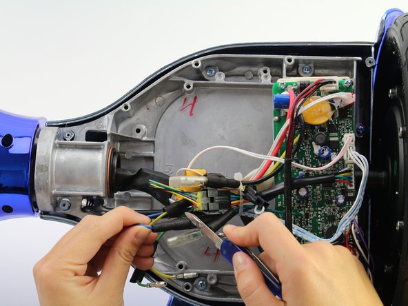

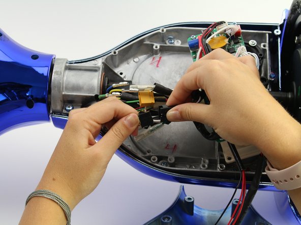

  12. Hover-1 Titan Wheel and Motor Replacement: crwdns2935265:012crwdnd2935265:01crwdnd2935265:03crwdne2935265:0 Hover-1 Titan Wheel and Motor Replacement: crwdns2935265:012crwdnd2935265:02crwdnd2935265:03crwdne2935265:0 Hover-1 Titan Wheel and Motor Replacement: crwdns2935265:012crwdnd2935265:03crwdnd2935265:03crwdne2935265:0
    • Unplug the rainbow connector by squeezing the clips and pulling apart.
  13. Hover-1 Titan Wheel and Motor Replacement: crwdns2935265:013crwdnd2935265:01crwdnd2935265:02crwdne2935265:0 Hover-1 Titan Wheel and Motor Replacement: crwdns2935265:013crwdnd2935265:02crwdnd2935265:02crwdne2935265:0
    • Use scissors to cut the zip tie around the group of wires.
  14. Hover-1 Titan Wheel and Motor Replacement: crwdns2935265:014crwdnd2935265:01crwdnd2935265:03crwdne2935265:0 Hover-1 Titan Wheel and Motor Replacement: crwdns2935265:014crwdnd2935265:02crwdnd2935265:03crwdne2935265:0 Hover-1 Titan Wheel and Motor Replacement: crwdns2935265:014crwdnd2935265:03crwdnd2935265:03crwdne2935265:0
    • Unplug the white wire connector by squeezing the clips and pulling apart.

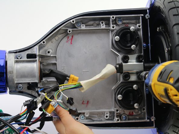

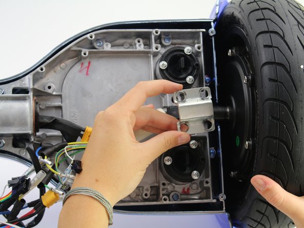

  15. Hover-1 Titan Wheel and Motor Replacement: crwdns2935265:015crwdnd2935265:01crwdnd2935265:02crwdne2935265:0 Hover-1 Titan Wheel and Motor Replacement: crwdns2935265:015crwdnd2935265:02crwdnd2935265:02crwdne2935265:0
    • Use an impact driver with a hex 6 bit to loosen the four 20 mm hex 6 bolts.
    • Wear safety glasses while using the impact driver.

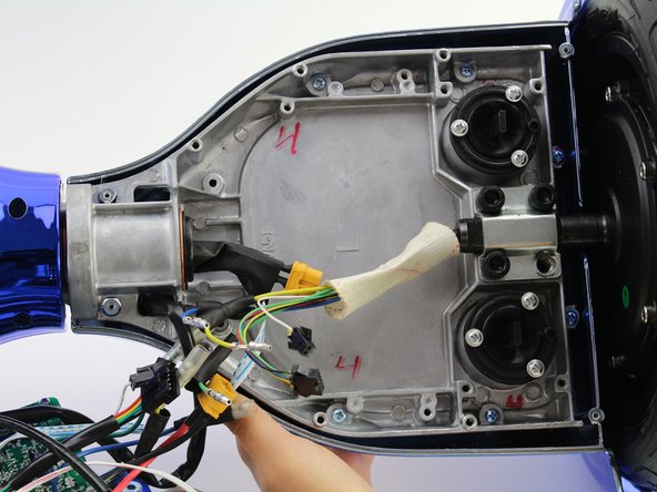

  16. Hover-1 Titan Wheel and Motor Replacement: crwdns2935265:016crwdnd2935265:01crwdnd2935265:03crwdne2935265:0 Hover-1 Titan Wheel and Motor Replacement: crwdns2935265:016crwdnd2935265:02crwdnd2935265:03crwdne2935265:0 Hover-1 Titan Wheel and Motor Replacement: crwdns2935265:016crwdnd2935265:03crwdnd2935265:03crwdne2935265:0

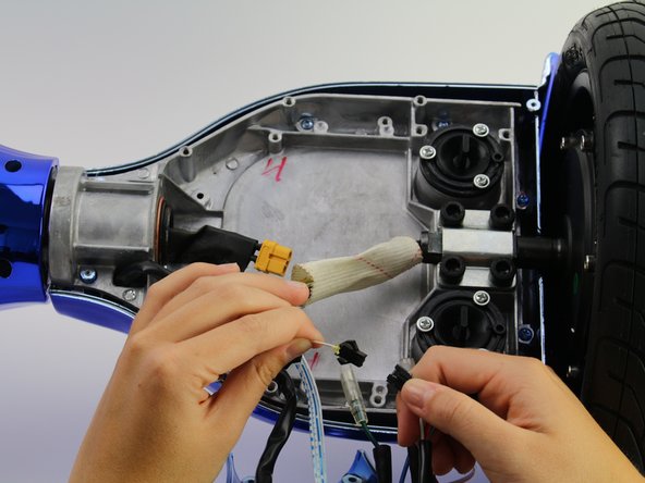

    • Pull out the loosened screws with your hands and remove the metal plate.

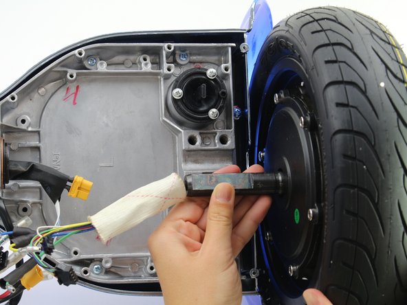

  17. Hover-1 Titan Wheel and Motor Replacement: crwdns2935265:017crwdnd2935265:01crwdnd2935265:02crwdne2935265:0 Hover-1 Titan Wheel and Motor Replacement: crwdns2935265:017crwdnd2935265:02crwdnd2935265:02crwdne2935265:0
    • Lift the wheel and motor shaft up and out of the board.
    • The motor shaft is located within the wheel.
