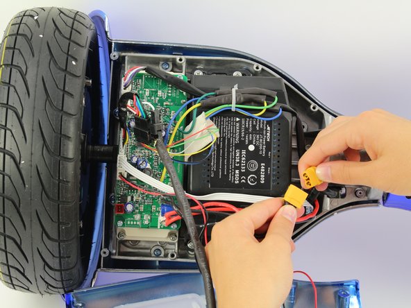

    • Unplug the battery from the gyroscope/motherboard by holding the yellow connector and pulling apart.

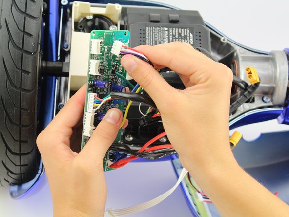

    • Remove four 12 mm Phillips #1 head screws from the corners of the green gyroscope/motherboard.

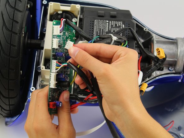

    • Unplug the bottom left connector by squeezing it and pulling it away from the board.

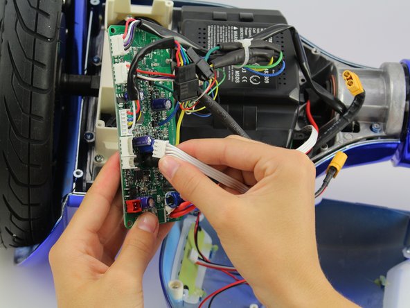

    • Unplug the white wires by squeezing the connector and pulling away from the board.

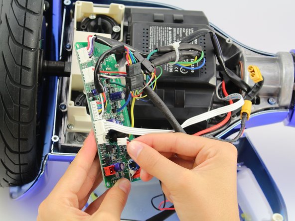

    • Unplug one set of the red, white, purple, and black wires by squeezing the connector and pulling away from the board.

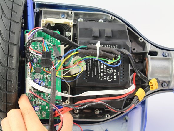

    • Cut the cable tie and unplug the remaining wires.
