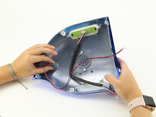

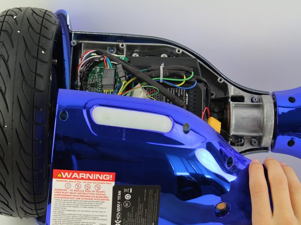

      • Flip the hoverboard so the bottom is facing up.
      • The right side is the side that has the power button. There is also an "R" on the metal plate underneath the battery.
    2. Hover-1 Titan Power Button Replacement: crwdns2935265:02crwdnd2935265:01crwdnd2935265:02crwdne2935265:0 Hover-1 Titan Power Button Replacement: crwdns2935265:02crwdnd2935265:02crwdnd2935265:02crwdne2935265:0
      • Using a Phillips #1 screwdriver, remove the two 14 mm screws closest to the center of the hoverboard.
      • Using a Phillips #1 screwdriver, remove the four 12 mm screws located in the middle of the panel.
      • Using a Phillips #1 screwdriver, remove the two 15 mm screws located closest to the wheel.

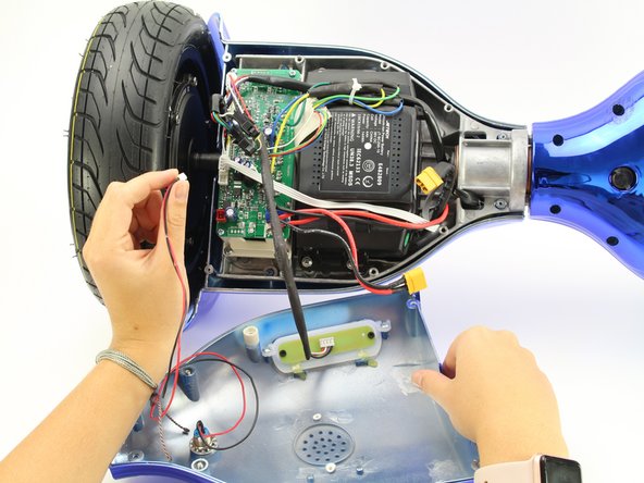

      • Disconnect the battery by holding the yellow connectors and pulling apart.
    2. Hover-1 Titan Power Button Replacement: crwdns2935265:05crwdnd2935265:01crwdnd2935265:03crwdne2935265:0 Hover-1 Titan Power Button Replacement: crwdns2935265:05crwdnd2935265:02crwdnd2935265:03crwdne2935265:0 Hover-1 Titan Power Button Replacement: crwdns2935265:05crwdnd2935265:03crwdnd2935265:03crwdne2935265:0

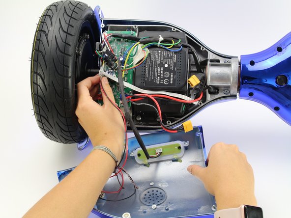

      • Unplug the red and black power button connector on the motherboard by squeezing the connector and pulling away from the board.
      • You can also unplug the light connector to free up your work space.

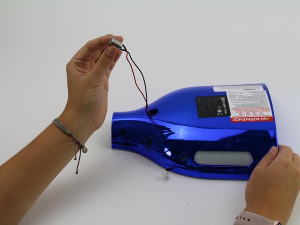

      • Use an adjustable wrench to remove the 14 mm nut holding the button in the shell.
    4. Hover-1 Titan Power Button Replacement: crwdns2935265:07crwdnd2935265:01crwdnd2935265:03crwdne2935265:0 Hover-1 Titan Power Button Replacement: crwdns2935265:07crwdnd2935265:02crwdnd2935265:03crwdne2935265:0 Hover-1 Titan Power Button Replacement: crwdns2935265:07crwdnd2935265:03crwdnd2935265:03crwdne2935265:0

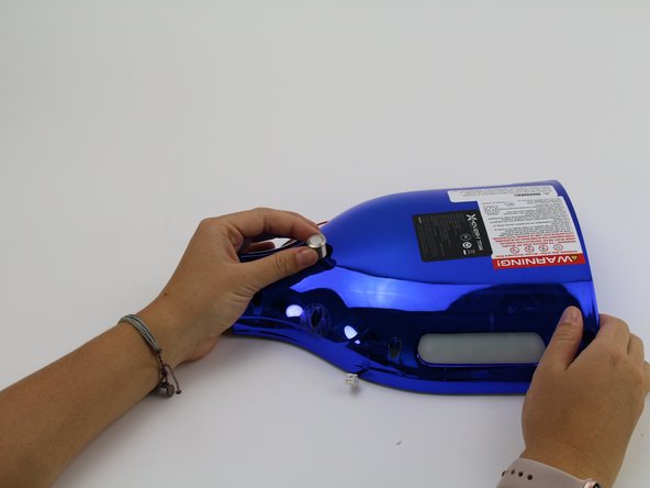

      • Pull the power button out of the panel.
      • Replace the power button.
