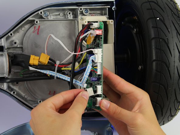

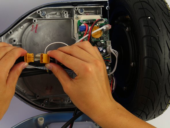

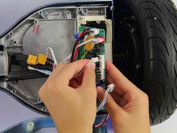

    1. Hover-1 Titan Left Gyroscope Replacement, Left Gyroscope and Motherboard: crwdns2935265:04crwdnd2935265:01crwdnd2935265:02crwdne2935265:0 Hover-1 Titan Left Gyroscope Replacement, Left Gyroscope and Motherboard: crwdns2935265:04crwdnd2935265:02crwdnd2935265:02crwdne2935265:0
      • Unplug the battery from the gyroscope by holding the yellow connector and pulling apart.
    2. Hover-1 Titan Left Gyroscope Replacement: crwdns2935265:05crwdnd2935265:01crwdnd2935265:03crwdne2935265:0 Hover-1 Titan Left Gyroscope Replacement: crwdns2935265:05crwdnd2935265:02crwdnd2935265:03crwdne2935265:0 Hover-1 Titan Left Gyroscope Replacement: crwdns2935265:05crwdnd2935265:03crwdnd2935265:03crwdne2935265:0

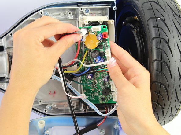

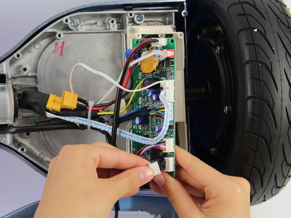

      • Remove four 12 mm Phillips #1 head screws from the corners of the green gyroscope/motherboard.
    3. Hover-1 Titan Left Gyroscope Replacement: crwdns2935265:06crwdnd2935265:01crwdnd2935265:02crwdne2935265:0 Hover-1 Titan Left Gyroscope Replacement: crwdns2935265:06crwdnd2935265:02crwdnd2935265:02crwdne2935265:0
      • Unplug the bottom right connector by squeezing it and pulling it away from the board.
    4. Hover-1 Titan Left Gyroscope Replacement: crwdns2935265:07crwdnd2935265:01crwdnd2935265:02crwdne2935265:0 Hover-1 Titan Left Gyroscope Replacement: crwdns2935265:07crwdnd2935265:02crwdnd2935265:02crwdne2935265:0
      • Unplug the light connector by squeezing it and pulling away from the board.

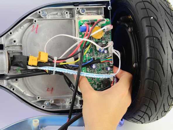

    5. Hover-1 Titan Left Gyroscope Replacement: crwdns2935265:08crwdnd2935265:01crwdnd2935265:02crwdne2935265:0 Hover-1 Titan Left Gyroscope Replacement: crwdns2935265:08crwdnd2935265:02crwdnd2935265:02crwdne2935265:0
      • Unplug the blue and white wires by squeezing the connector and pulling away from the board.
    6. Hover-1 Titan Left Gyroscope Replacement: crwdns2935265:09crwdnd2935265:01crwdnd2935265:02crwdne2935265:0 Hover-1 Titan Left Gyroscope Replacement: crwdns2935265:09crwdnd2935265:02crwdnd2935265:02crwdne2935265:0
      • Unplug the small white connector by squeezing it and pulling away from the board.
    7. Hover-1 Titan Left Gyroscope Replacement: crwdns2935265:010crwdnd2935265:01crwdnd2935265:02crwdne2935265:0 Hover-1 Titan Left Gyroscope Replacement: crwdns2935265:010crwdnd2935265:02crwdnd2935265:02crwdne2935265:0
      • Unplug the plug in the red connector.
      • The red plug is glued to the board, so this step will require extra force.

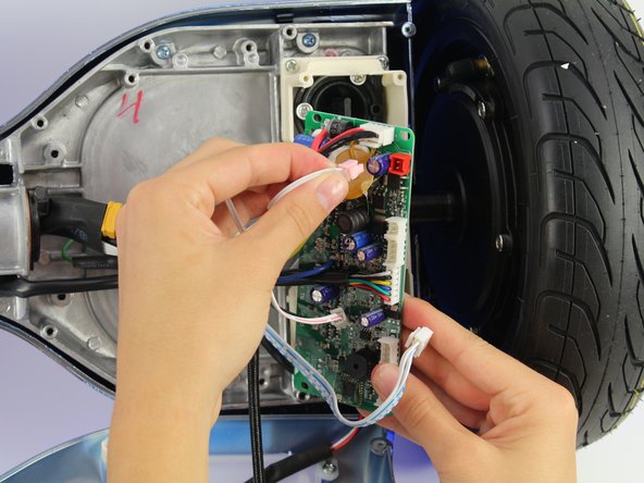

    8. Hover-1 Titan Left Gyroscope Replacement: crwdns2935265:011crwdnd2935265:01crwdnd2935265:02crwdne2935265:0 Hover-1 Titan Left Gyroscope Replacement: crwdns2935265:011crwdnd2935265:02crwdnd2935265:02crwdne2935265:0
      • Unplug the charging cable connector by squeezing it and pulling it away from the board.

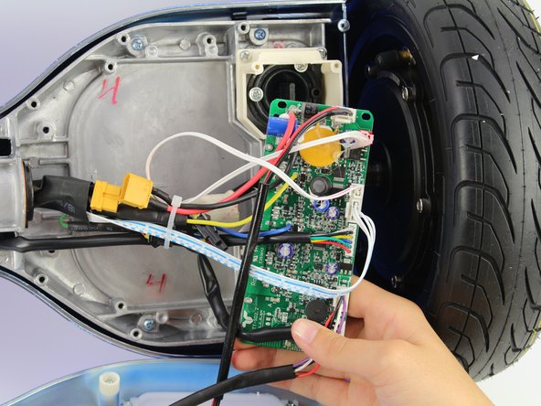

    9. Hover-1 Titan Left Gyroscope Replacement: crwdns2935265:012crwdnd2935265:01crwdnd2935265:01crwdne2935265:0
      • Cut the cable tie.
      • Unplug the remaining wires.
      • The connectors for the remaining wires are in the rubber covers.
