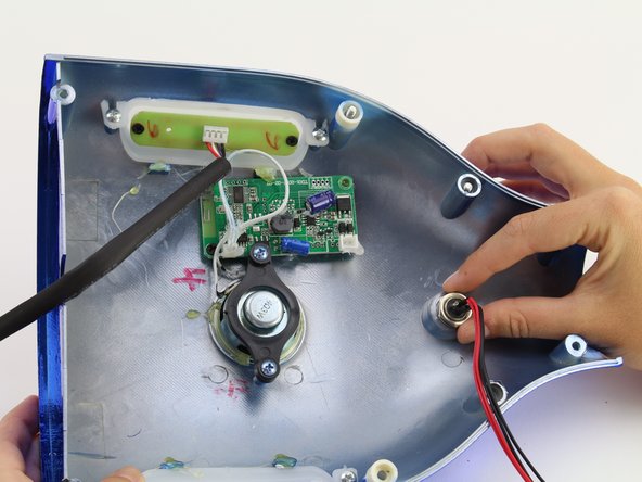

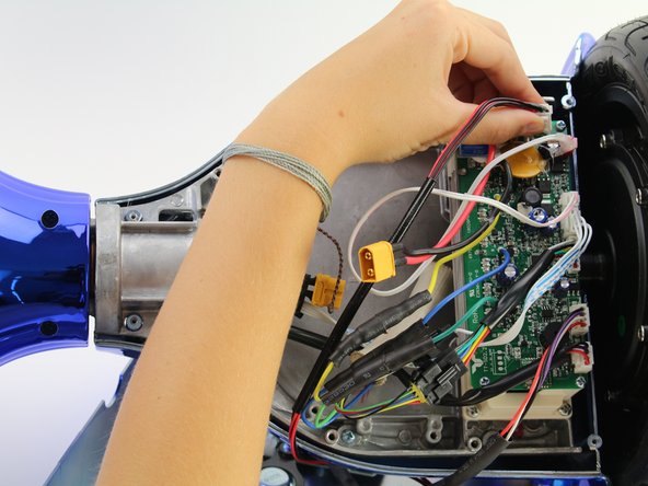

    • Unplug the red and black charge port wire from the motherboard by squeezing the connector located at the top right of the motherboard and pulling the connector away from the board.

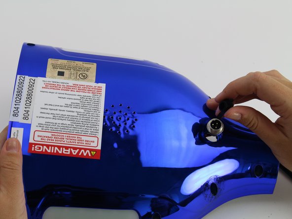

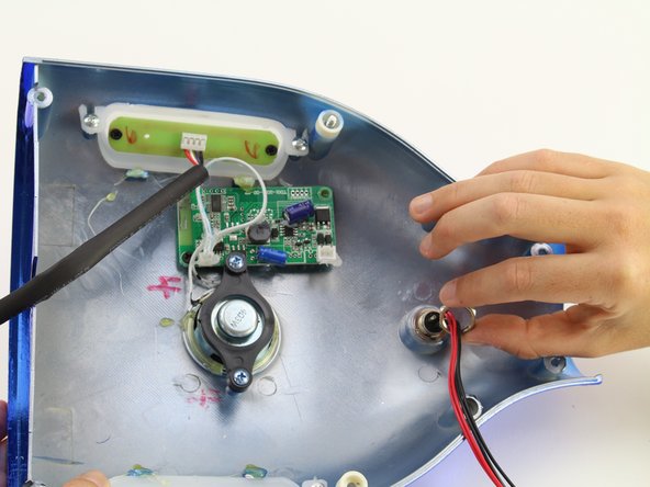

    • Use an adjustable wrench to loosen the 14 mm nut and lift it off the charge port.
  6. Hover-1 Titan Charge Port Replacement: crwdns2935265:06crwdnd2935265:01crwdnd2935265:02crwdne2935265:0 Hover-1 Titan Charge Port Replacement: crwdns2935265:06crwdnd2935265:02crwdnd2935265:02crwdne2935265:0
    • Remove the old charge port by pulling the wires all the way through the panel.
    • Replace the old charge port with the new charge port.
