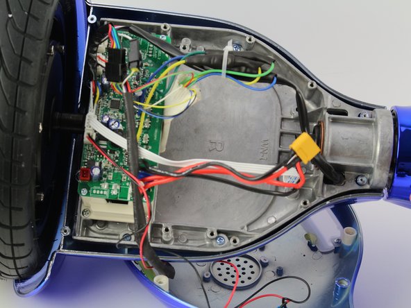

    • Flip the hoverboard so the bottom is facing up.
    • The right side is the side that has the power button. There is also an "R" on the metal plate underneath the battery.
  2. Hover-1 Titan Battery Replacement: crwdns2935265:02crwdnd2935265:01crwdnd2935265:02crwdne2935265:0 Hover-1 Titan Battery Replacement: crwdns2935265:02crwdnd2935265:02crwdnd2935265:02crwdne2935265:0
    • Using a Phillips #1 screwdriver, remove the two 14 mm screws closest to the center of the hoverboard.
    • Using a Phillips #1 screwdriver, remove the four 12 mm screws located in the middle of the panel.
    • Using a Phillips #1 screwdriver, remove the two 15 mm screws located closest to the wheel.
  3. Hover-1 Titan Battery Replacement: crwdns2935265:03crwdnd2935265:01crwdnd2935265:03crwdne2935265:0 Hover-1 Titan Battery Replacement: crwdns2935265:03crwdnd2935265:02crwdnd2935265:03crwdne2935265:0 Hover-1 Titan Battery Replacement: crwdns2935265:03crwdnd2935265:03crwdnd2935265:03crwdne2935265:0
    • Grip the bottom right panel and lift to remove it.

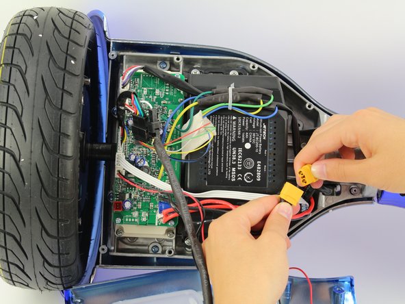

  4. Hover-1 Titan Battery Replacement, Battery: crwdns2935265:04crwdnd2935265:01crwdnd2935265:02crwdne2935265:0 Hover-1 Titan Battery Replacement, Battery: crwdns2935265:04crwdnd2935265:02crwdnd2935265:02crwdne2935265:0
    • Unplug the battery from the gyroscope/motherboard by holding the yellow connector and pulling apart.
  5. Hover-1 Titan Battery Replacement: crwdns2935265:05crwdnd2935265:01crwdnd2935265:02crwdne2935265:0 Hover-1 Titan Battery Replacement: crwdns2935265:05crwdnd2935265:02crwdnd2935265:02crwdne2935265:0
    • Remove the bundle of wires from the clip on the top of the battery.
  6. Hover-1 Titan Battery Replacement: crwdns2935265:06crwdnd2935265:01crwdnd2935265:02crwdne2935265:0 Hover-1 Titan Battery Replacement: crwdns2935265:06crwdnd2935265:02crwdnd2935265:02crwdne2935265:0
    • Using a Phillips #1 screwdriver, remove the four 14 mm screws that hold the battery on the device.
  7. Hover-1 Titan Battery Replacement: crwdns2935265:07crwdnd2935265:01crwdnd2935265:03crwdne2935265:0 Hover-1 Titan Battery Replacement: crwdns2935265:07crwdnd2935265:02crwdnd2935265:03crwdne2935265:0 Hover-1 Titan Battery Replacement: crwdns2935265:07crwdnd2935265:03crwdnd2935265:03crwdne2935265:0
    • Remove the battery out of the hoverboard by lifting the battery then sliding it out from under the wires.
