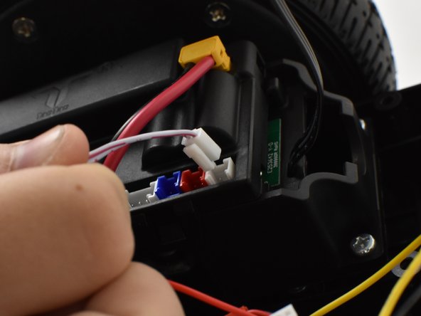

      • Locate the cable connected to the front lights.
      • Pull apart the wires until the black clip separates.

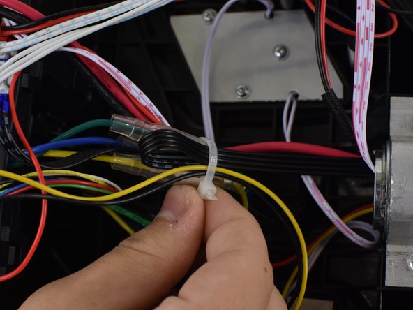

      • Cut both zip-ties that secure the circuit board box and the wire bundle near the center of the device together.

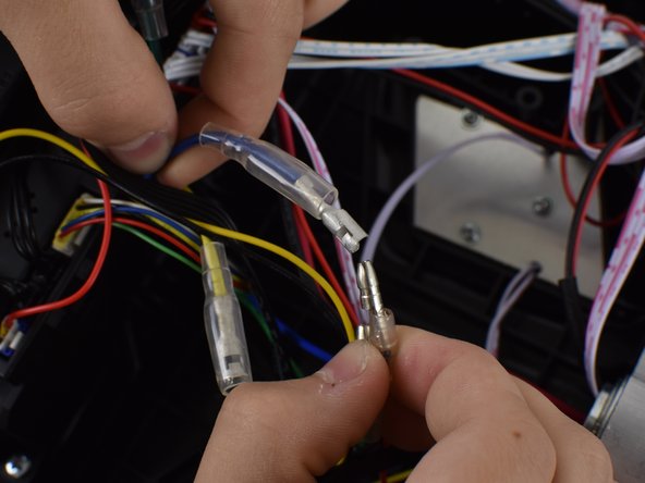

    2. Hover-1 Superstar Right Gyroscope Sensor Sensor Board: crwdns2935265:04crwdnd2935265:01crwdnd2935265:03crwdne2935265:0 Hover-1 Superstar Right Gyroscope Sensor Sensor Board: crwdns2935265:04crwdnd2935265:02crwdnd2935265:03crwdne2935265:0 Hover-1 Superstar Right Gyroscope Sensor Sensor Board: crwdns2935265:04crwdnd2935265:03crwdnd2935265:03crwdne2935265:0

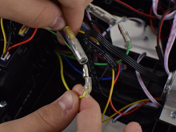

      • Unplug all three of the cables that were previously zip-tied. They are the cables that are connected with a clear sleeve near the center of the device.

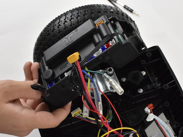

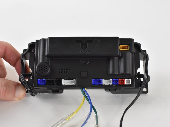

      • Unplug the colored connectors feeding through the top of the circuit board box. For the most part the colors correspond to each other, but make sure to take pictures to remember which connector goes in the correct position.

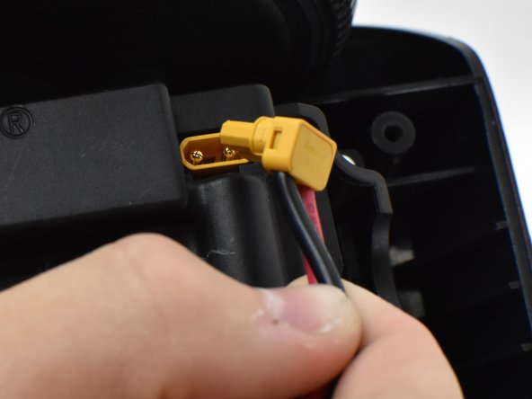

      • Unplug the yellow connector at the top right corner of the circuit board box.
    4. Hover-1 Superstar Right Gyroscope Sensor Sensor Board: crwdns2935265:06crwdnd2935265:01crwdnd2935265:03crwdne2935265:0 Hover-1 Superstar Right Gyroscope Sensor Sensor Board: crwdns2935265:06crwdnd2935265:02crwdnd2935265:03crwdne2935265:0 Hover-1 Superstar Right Gyroscope Sensor Sensor Board: crwdns2935265:06crwdnd2935265:03crwdnd2935265:03crwdne2935265:0
      • Using a Phillips #1 screwdriver, remove the four 14mm screws securing the circuit board box in place.
      • Remove the circuit board box from the hoverboard.

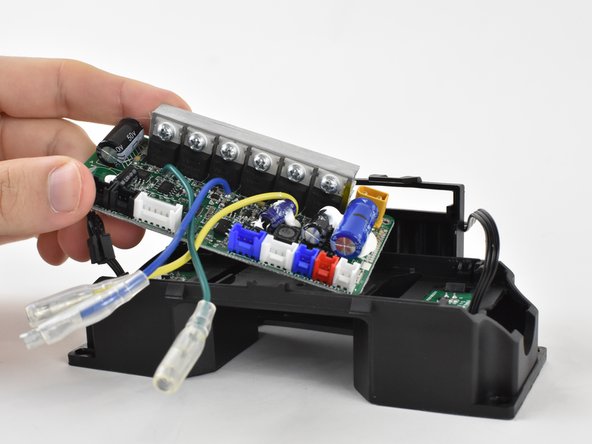

      • Unclip the top of the circuit board box from the bottom.
      • Remove the balance sensor circuit board.

I’m trying to repair a hover-1 Allstar for my nephew. I thought I salved it by purchasing a new board but once I plugged it back in I have the same symptoms. Those symptoms are once it’s turned on it will immediately start to beep and the red battery light turns on. Nothing I do will get it to stop beeping unless I turn it off. The battery is fully charged, so the only other thing that came to mind was to check the motor hall sensors. Those all worked and tested perfectly. I’m out of ideas, can anyone help me?
