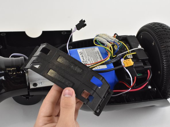

      • Flip your Hover-1 Superstar device upside down.
      • Using a Phillips #1 screwdriver, remove all twenty of the 18mm screws holding the case onto the device.
      • Remove the bottom case. Be careful of the connector holding the case and the device together.
    2. Hover-1 Superstar Battery Replacement: crwdns2935265:02crwdnd2935265:01crwdnd2935265:01crwdne2935265:0
      • Locate the cable connected to the front lights.
      • Pull apart the wires until the black clip separates.
    1. Hover-1 Superstar Battery Replacement, Battery: crwdns2935265:03crwdnd2935265:01crwdnd2935265:02crwdne2935265:0 Hover-1 Superstar Battery Replacement, Battery: crwdns2935265:03crwdnd2935265:02crwdnd2935265:02crwdne2935265:0
      • Locate the four 14mm screws securing the battery bracket.
      • Remove the screws with a Phillips #1 screwdriver.
    2. Hover-1 Superstar Battery Replacement: crwdns2935265:04crwdnd2935265:01crwdnd2935265:01crwdne2935265:0
      • Pull and disconnect the cable connector that is connected to the battery.
    3. Hover-1 Superstar Battery Replacement: crwdns2935265:05crwdnd2935265:01crwdnd2935265:01crwdne2935265:0
      • Pull on the battery until it separates from the hover board. You may need to use some force.
      • Be sure the battery is disconnected before performing this step to avoid electrocution.
      • There will be a loud crack when the battery is removed. This is normal due to the adhesive on the back of the battery.
      • Pull the battery out of the hoverboard. Move wires away from the battery if necessary.
