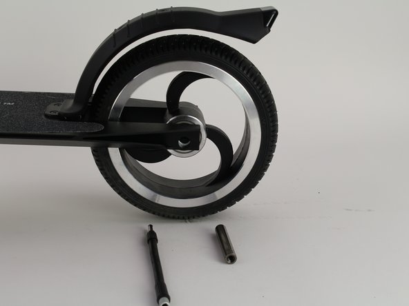

    • Use a 4 mm bit extension to push the axle out of the wheel’s center.
  4. Hover-1 Rally Brake Pad Replacement: crwdns2935265:04crwdnd2935265:01crwdnd2935265:01crwdne2935265:0
    • Grab the deck of the scooter, and pull the wheel downwards.
    • 2 washers will fall out with the wheel.
