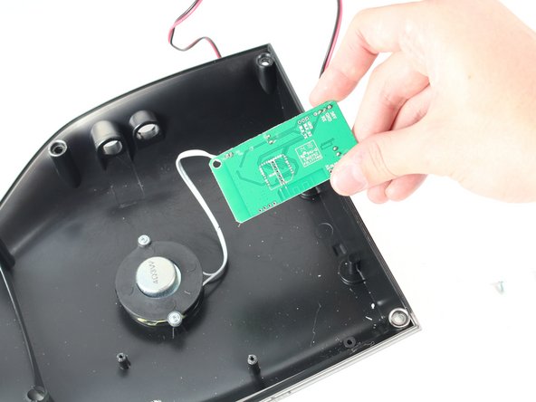

  5. Hover-1 Nomad Speaker Assembly Replacement, Speaker Assembly: crwdns2935265:05crwdnd2935265:01crwdnd2935265:02crwdne2935265:0 Hover-1 Nomad Speaker Assembly Replacement, Speaker Assembly: crwdns2935265:05crwdnd2935265:02crwdnd2935265:02crwdne2935265:0
    • Remove the two 13mm Phillips #1 screws in the corners of the speaker assembly circuit board.
    • You cannot fully disconnect the circuit board from the speaker. Set it aside for now.

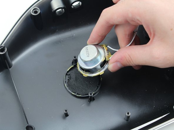

  8. Hover-1 Nomad Speaker Assembly Replacement: crwdns2935265:08crwdnd2935265:01crwdnd2935265:02crwdne2935265:0 Hover-1 Nomad Speaker Assembly Replacement: crwdns2935265:08crwdnd2935265:02crwdnd2935265:02crwdne2935265:0
    • Break the glue connecting the speaker to the outer shell by prying the speaker up with a nylon spudger.
    • Lift the speaker off the outer shell.

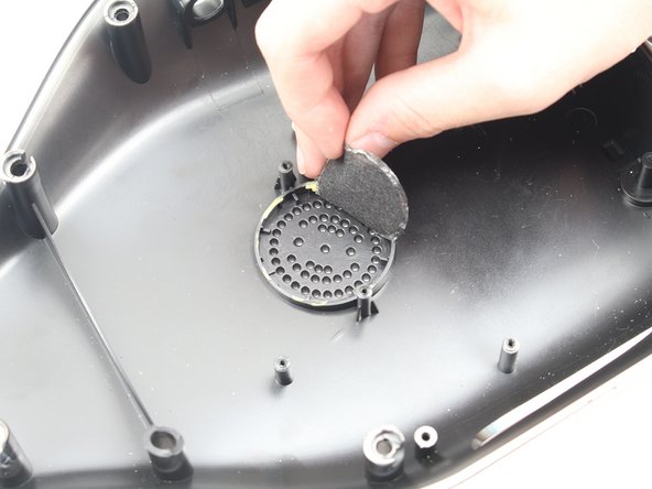

  9. Hover-1 Nomad Speaker Assembly Replacement: crwdns2935265:09crwdnd2935265:01crwdnd2935265:02crwdne2935265:0 Hover-1 Nomad Speaker Assembly Replacement: crwdns2935265:09crwdnd2935265:02crwdnd2935265:02crwdne2935265:0
    • Use a nylon spudger to scrape the fabric speaker cover off the outer shell.
    • Peel the fabric off the outer shell.
    • New speakers and fabric will already be glued together. Apply the whole assembly to the outer shell at once during reassembly.
