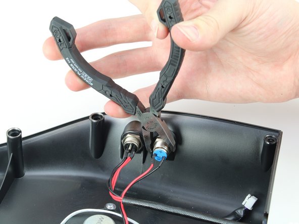

    1. Hover-1 Nomad Power Button Replacement, Power Button: crwdns2935265:05crwdnd2935265:01crwdnd2935265:02crwdne2935265:0 Hover-1 Nomad Power Button Replacement, Power Button: crwdns2935265:05crwdnd2935265:02crwdnd2935265:02crwdne2935265:0
      • Peel off the glue around the power button.
      • Unscrew the hexagonal nut around the power button by rotating the nut counterclockwise with a pair of pliers.
    2. Hover-1 Nomad Power Button Replacement: crwdns2935265:06crwdnd2935265:01crwdnd2935265:01crwdne2935265:0
      • Feed the wire and connector through the removed nut and pull the power button out through the hole in the outer casing.
