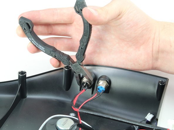

  5. Hover-1 Nomad Charging Port Replacement, Charging Port: crwdns2935265:05crwdnd2935265:01crwdnd2935265:02crwdne2935265:0 Hover-1 Nomad Charging Port Replacement, Charging Port: crwdns2935265:05crwdnd2935265:02crwdnd2935265:02crwdne2935265:0
    • Peel off the glue around the charging port.
    • Unscrew the hexagonal nut around the charging port by rotating the nut counterclockwise with a pair of pliers.
  6. Hover-1 Nomad Charging Port Replacement: crwdns2935265:06crwdnd2935265:01crwdnd2935265:01crwdne2935265:0
    • Feed the wire and connector through the removed nut and pull the charging port out through the hole in the outer casing.
    • Pulling the connector through the nut is a tight fit. Try turning the plug sideways to fit the connector through the nut.
