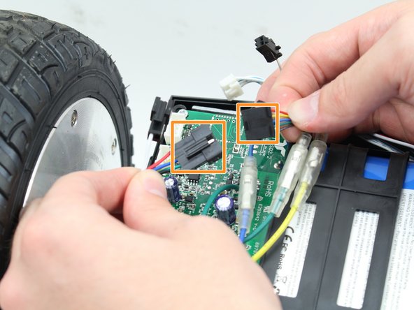

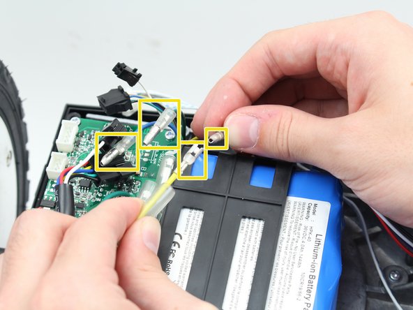

      • Disconnect the following wires connecting the circuit boards to the sensors and motors:
      • Disconnect the white connectors by pinching the tab and pulling up on the connectors.
      • Disconnect the black connectors by pulling the two sides apart.
      • Disconnect the green, yellow, and blue cables by pulling back the plastic shielding and pulling the ends apart.

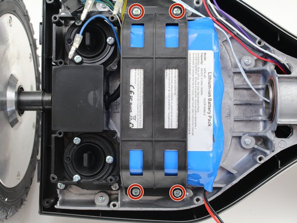

    1. Hover-1 Nomad Battery Replacement, Battery: crwdns2935265:010crwdnd2935265:01crwdnd2935265:02crwdne2935265:0 Hover-1 Nomad Battery Replacement, Battery: crwdns2935265:010crwdnd2935265:02crwdnd2935265:02crwdne2935265:0
      • Remove the four 15mm screws from the battery cage with a Phillips #2 screwdriver.
      • Do not puncture or cut the lithium-ion battery. Especially with a battery this large, the battery can catch fire or explode if damaged.
    2. Hover-1 Nomad Battery Replacement: crwdns2935265:011crwdnd2935265:01crwdnd2935265:02crwdne2935265:0 Hover-1 Nomad Battery Replacement: crwdns2935265:011crwdnd2935265:02crwdnd2935265:02crwdne2935265:0
      • Lift the battery cage up and off the battery.
    3. Hover-1 Nomad Battery Replacement: crwdns2935265:012crwdnd2935265:01crwdnd2935265:01crwdne2935265:0
      • Remove the battery by lifting it off the hoverboard frame.
      • The battery is attached to the frame with an adhesive strip. It can be removed by hand with some force.
