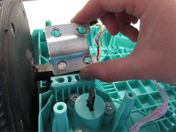

  5. Hover-1 Maverick Motor Wheel Replacement, Motor: crwdns2935265:06crwdnd2935265:01crwdnd2935265:02crwdne2935265:0 Hover-1 Maverick Motor Wheel Replacement, Motor: crwdns2935265:06crwdnd2935265:02crwdnd2935265:02crwdne2935265:0
    • After the motherboard is removed from either side, remove the four 15 mm hex screws with a 5mm Allen wrench.
    • Remove the metal covering from over the motor.
  6. Hover-1 Maverick Motor Wheel Replacement: crwdns2935265:07crwdnd2935265:01crwdnd2935265:01crwdne2935265:0
    • The motor is attached to the wheel, so in order to remove the motor, you must take out the entire wheel.
