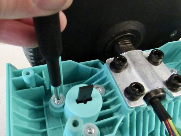

    • *Using a 15mm Phillips screwdriver remove the 20 #1 screws from the shell of the hoverboard.
    • Open the shell.
    • There is one motherboard on each side of the device located near the wheels.
    • Turn off hoverboard.
  2. Hover-1 Maverick Foot Mats Replacement: crwdns2935265:03crwdnd2935265:01crwdnd2935265:02crwdne2935265:0 Hover-1 Maverick Foot Mats Replacement: crwdns2935265:03crwdnd2935265:02crwdnd2935265:02crwdne2935265:0
    • Disconnect the battery to prevent any electrical currents from coming through the wires.
  3. Hover-1 Maverick Foot Mats Replacement: crwdns2935265:04crwdnd2935265:01crwdnd2935265:02crwdne2935265:0 Hover-1 Maverick Foot Mats Replacement: crwdns2935265:04crwdnd2935265:02crwdnd2935265:02crwdne2935265:0
    • Squeeze and pull on the wires to detach them from the motherboard.
  4. Hover-1 Maverick Foot Mats Replacement: crwdns2935265:05crwdnd2935265:01crwdnd2935265:02crwdne2935265:0 Hover-1 Maverick Foot Mats Replacement: crwdns2935265:05crwdnd2935265:02crwdnd2935265:02crwdne2935265:0
    • Remove the four 8mm Phillips #1 screws.
    • Remove the motherboard from the device.
    • Repeat for the other motherboard.
  5. Hover-1 Maverick Foot Mats Replacement, Foot Mats: crwdns2935265:06crwdnd2935265:01crwdnd2935265:02crwdne2935265:0 Hover-1 Maverick Foot Mats Replacement, Foot Mats: crwdns2935265:06crwdnd2935265:02crwdnd2935265:02crwdne2935265:0
    • Remove six 1mm Phillips #1 screws.
  6. Hover-1 Maverick Foot Mats Replacement: crwdns2935265:07crwdnd2935265:01crwdnd2935265:01crwdne2935265:0
    • Remove the foot mats from the top of the board, which is facing down right now.
