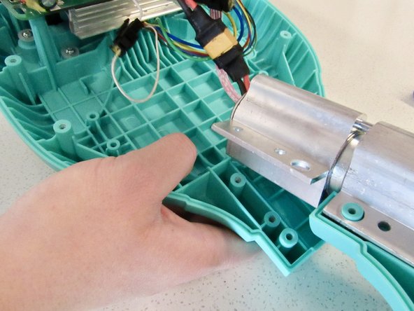

  4. Hover-1 Maverick Central Bearing Replacement: crwdns2935265:04crwdnd2935265:01crwdnd2935265:02crwdne2935265:0 Hover-1 Maverick Central Bearing Replacement: crwdns2935265:04crwdnd2935265:02crwdnd2935265:02crwdne2935265:0
    • One side of the bearing is easy to pop out with your hands.

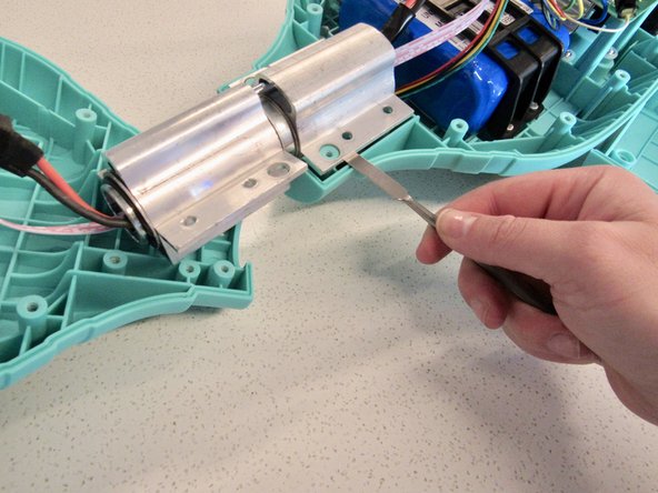

    • The other side of the bearing has wiring for the LED light running under it, so it cannot be pulled out with your hands. To get leverage, carefully use the metal spudger to wedge out this other side.
  5. Hover-1 Maverick Central Bearing Replacement: crwdns2935265:05crwdnd2935265:01crwdnd2935265:01crwdne2935265:0
    • Take the central bearing out of the board.
