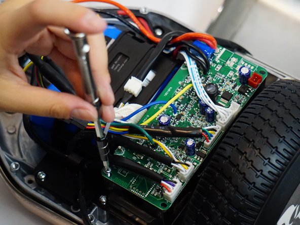

  4. Hover-1 Matrix Pad Replacement: crwdns2935265:04crwdnd2935265:01crwdnd2935265:02crwdne2935265:0 Hover-1 Matrix Pad Replacement: crwdns2935265:04crwdnd2935265:02crwdnd2935265:02crwdne2935265:0
    • Start by identifying the motherboard, which is the green pad shown in the picture.
    • Remove the screws on the corners of the motherboard with the Phillips #1 screwdriver and take it off.
    • There are cables attached to the motherboard so go ahead and unattach them.

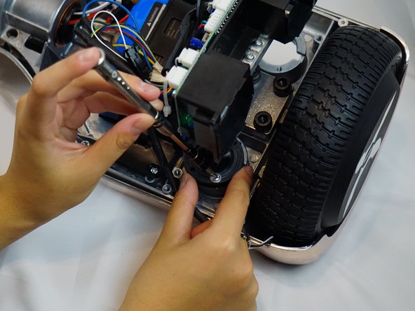

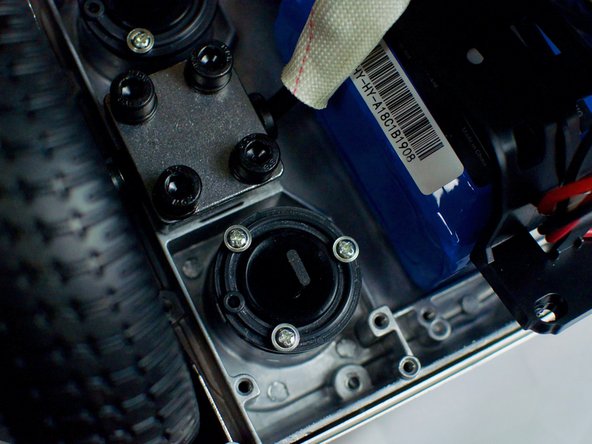

  5. Hover-1 Matrix Pad Replacement: crwdns2935265:05crwdnd2935265:01crwdnd2935265:03crwdne2935265:0 Hover-1 Matrix Pad Replacement: crwdns2935265:05crwdnd2935265:02crwdnd2935265:03crwdne2935265:0 Hover-1 Matrix Pad Replacement: crwdns2935265:05crwdnd2935265:03crwdnd2935265:03crwdne2935265:0
    • Use picture 1 as a guide and move the motherboard to the other side.
    • Identify the two black rubber buttons that are shown in the second picture.
    • Remove the two rubber buttons using the Phillips #1 screwdriver.
  6. Hover-1 Matrix Pad Replacement: crwdns2935265:06crwdnd2935265:01crwdnd2935265:01crwdne2935265:0
    • Removing the rubber buttons in the previous step allows you to take the pad off.
    • Finally, take off the old pad and put on a new pad.
