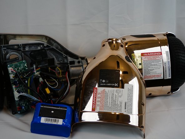

    • Remove the twenty screws from the top outer cover using a Phillips #1 screwdriver.
    • Lift the left and right sides of the outer cover away from the rest of the hoverboard.

    • Remove the screws from the battery cover using a Philiips #1 screwdriver.
  3. Hover-1 Matrix Battery Replacement: crwdns2935265:03crwdnd2935265:01crwdnd2935265:03crwdne2935265:0 Hover-1 Matrix Battery Replacement: crwdns2935265:03crwdnd2935265:02crwdnd2935265:03crwdne2935265:0 Hover-1 Matrix Battery Replacement: crwdns2935265:03crwdnd2935265:03crwdnd2935265:03crwdne2935265:0

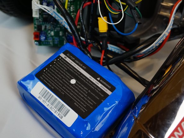

    • Move the plastic cover from the top of the battery.
    • Unplug the cables that connect to the battery and remove the battery from the hoverboard.
