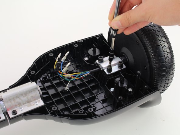

  9. Hover-1 Liberty Wheel Motor Replacement, Wheel Motor: crwdns2935265:09crwdnd2935265:01crwdnd2935265:02crwdne2935265:0 Hover-1 Liberty Wheel Motor Replacement, Wheel Motor: crwdns2935265:09crwdnd2935265:02crwdnd2935265:02crwdne2935265:0
    • Place the hoverboard so the four 36mm Allen bolts are pointing up.
    • Remove the four 36mm Allen bolts on each side using a 5mm Allen Wrench.
    • The four Allen bolts have lock washers.

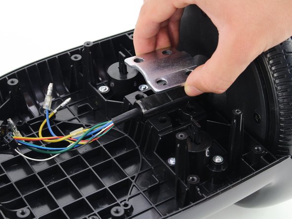

  10. Hover-1 Liberty Wheel Motor Replacement: crwdns2935265:010crwdnd2935265:01crwdnd2935265:02crwdne2935265:0 Hover-1 Liberty Wheel Motor Replacement: crwdns2935265:010crwdnd2935265:02crwdnd2935265:02crwdne2935265:0
    • Lift the metal retaining plate away from the motor shaft.

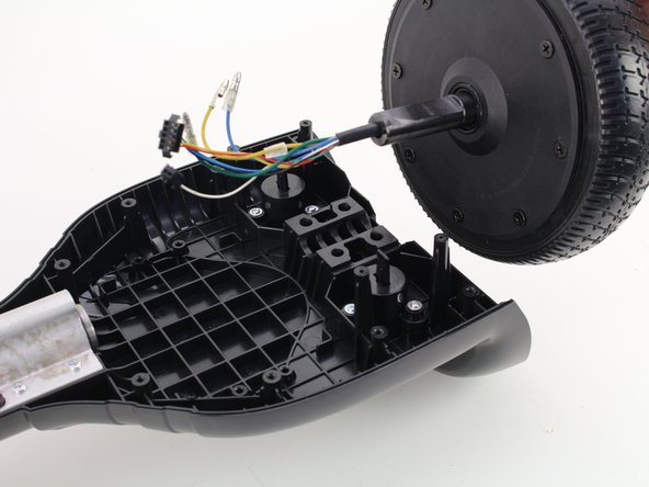

  11. Hover-1 Liberty Wheel Motor Replacement: crwdns2935265:011crwdnd2935265:01crwdnd2935265:02crwdne2935265:0 Hover-1 Liberty Wheel Motor Replacement: crwdns2935265:011crwdnd2935265:02crwdnd2935265:02crwdne2935265:0
    • Lift motor assembly away from hoverboard.
    • There is a flat section on the motor shaft that needs to point up, towards metal plate.
    • The motor assembly should be flush with side of hoverboard.
