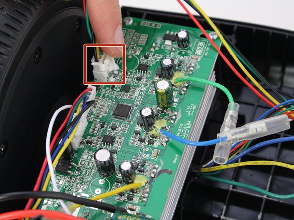

    • Remove one connector from the non-battery side circuit board.
    • Remove the next connector from the non-battery side circuit board.
    • To remove the connectors, pinch the plug and pull away from the circuit board.

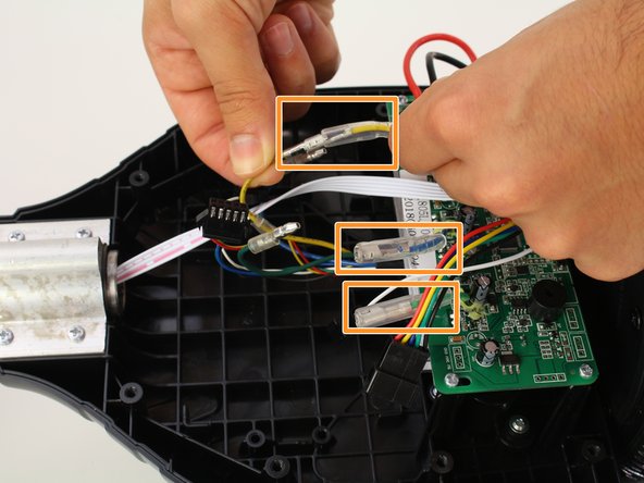

    • Remove battery connector by pulling it apart.
    • Slide the rubber sheaths away from the connector on the blue, green, and yellow wires.
    • Disconnect the colored wires by pulling them apart.
    • The large colored wires connecting the sensor boards to the wheels need to match for the motor to operate correctly.

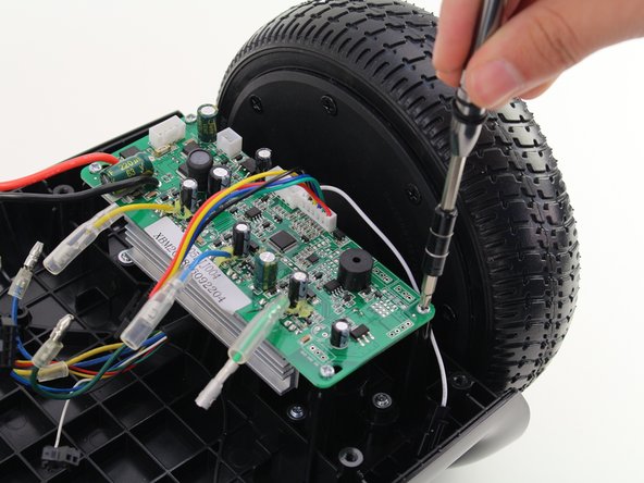

  7. Hover-1 Liberty Gyroscope Sensor Boards Replacement: crwdns2935265:07crwdnd2935265:01crwdnd2935265:02crwdne2935265:0 Hover-1 Liberty Gyroscope Sensor Boards Replacement: crwdns2935265:07crwdnd2935265:02crwdnd2935265:02crwdne2935265:0
    • Remove the four 10mm screws with a Phillips #1 screwdriver.

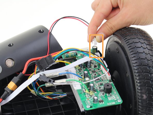

  8. Hover-1 Liberty Gyroscope Sensor Boards Replacement: crwdns2935265:08crwdnd2935265:01crwdnd2935265:02crwdne2935265:0 Hover-1 Liberty Gyroscope Sensor Boards Replacement: crwdns2935265:08crwdnd2935265:02crwdnd2935265:02crwdne2935265:0
    • Remove the sensor board by lifting it away from the hoverboard.
    • Repeat steps 4-8 to remove the sensor board from the other side.
