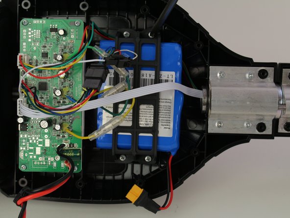

  3. Hover-1 Liberty Battery Replacement: crwdns2935265:03crwdnd2935265:01crwdnd2935265:03crwdne2935265:0 Hover-1 Liberty Battery Replacement: crwdns2935265:03crwdnd2935265:02crwdnd2935265:03crwdne2935265:0 Hover-1 Liberty Battery Replacement: crwdns2935265:03crwdnd2935265:03crwdnd2935265:03crwdne2935265:0
    • Remove one connector from the non-battery side circuit board.
    • Remove the next connector from the non-battery side circuit board.
    • To remove the connectors, pinch the plug and pull away from the circuit board.
  4. Hover-1 Liberty Battery Replacement, Battery: crwdns2935265:04crwdnd2935265:01crwdnd2935265:02crwdne2935265:0 Hover-1 Liberty Battery Replacement, Battery: crwdns2935265:04crwdnd2935265:02crwdnd2935265:02crwdne2935265:0
    • Disconnect the large red and black wire from the battery by pulling apart the connector.

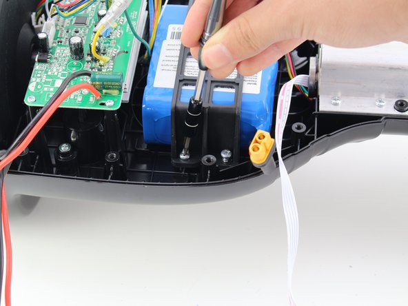

  5. Hover-1 Liberty Battery Replacement: crwdns2935265:05crwdnd2935265:01crwdnd2935265:02crwdne2935265:0 Hover-1 Liberty Battery Replacement: crwdns2935265:05crwdnd2935265:02crwdnd2935265:02crwdne2935265:0
    • Remove the four 15mm Phillips #1 screws from the bracket holding the battery in place.

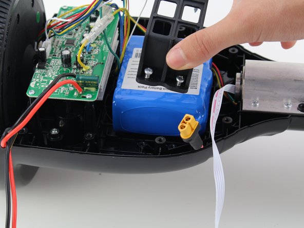

  6. Hover-1 Liberty Battery Replacement: crwdns2935265:06crwdnd2935265:01crwdnd2935265:02crwdne2935265:0 Hover-1 Liberty Battery Replacement: crwdns2935265:06crwdnd2935265:02crwdnd2935265:02crwdne2935265:0
    • Remove the bracket by pulling it upwards, away from the hoverboard.
    • You will need to move some wires aside to remove the bracket successfully.

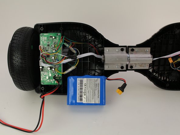

  7. Hover-1 Liberty Battery Replacement: crwdns2935265:07crwdnd2935265:01crwdnd2935265:03crwdne2935265:0 Hover-1 Liberty Battery Replacement: crwdns2935265:07crwdnd2935265:02crwdnd2935265:03crwdne2935265:0 Hover-1 Liberty Battery Replacement: crwdns2935265:07crwdnd2935265:03crwdnd2935265:03crwdne2935265:0
    • Remove the battery by grasping the battery and hoverboard firmly and pulling apart.
    • The battery is held in place by adhesive. So, some force is required to remove it.
