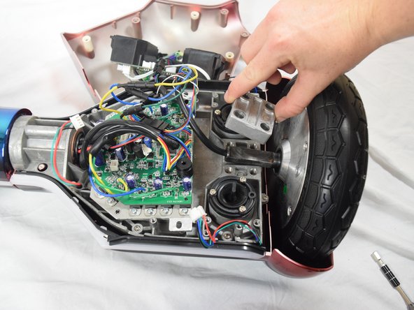

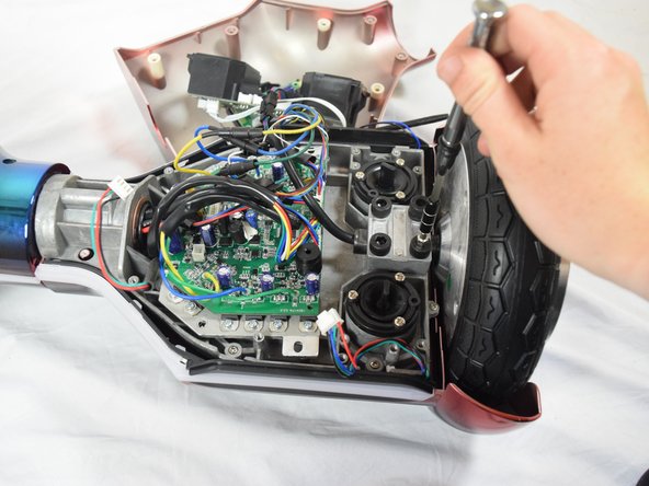

    • Remove the four 30mm Hex #6 screws.
    • Lift away the silver bracket and set it to the side.

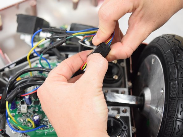

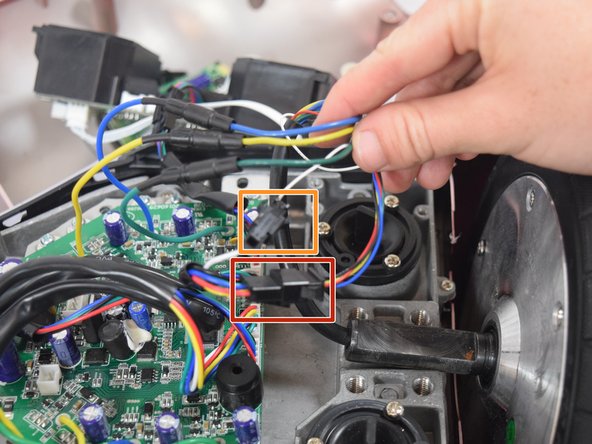

    • Disconnect the first clip by squeezing the latch that hold the clips together while pulling apart.
    • Disconnect the second clip by squeezing the tab while pulling the clip apart.
  12. Hover-1 Horizon Wheel/Motor Replacement: crwdns2935265:012crwdnd2935265:01crwdnd2935265:03crwdne2935265:0 Hover-1 Horizon Wheel/Motor Replacement: crwdns2935265:012crwdnd2935265:02crwdnd2935265:03crwdne2935265:0 Hover-1 Horizon Wheel/Motor Replacement: crwdns2935265:012crwdnd2935265:03crwdnd2935265:03crwdne2935265:0

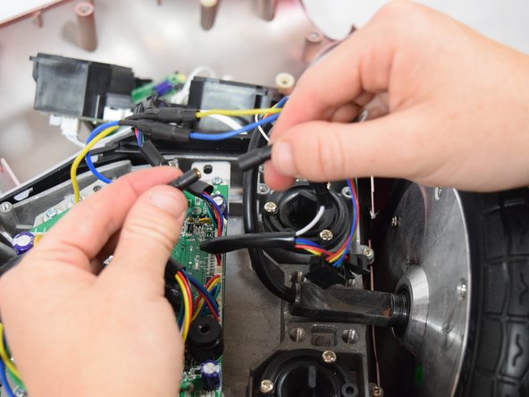

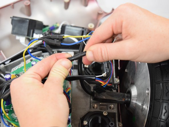

    • Detach the remaining three connections by pulling them apart.

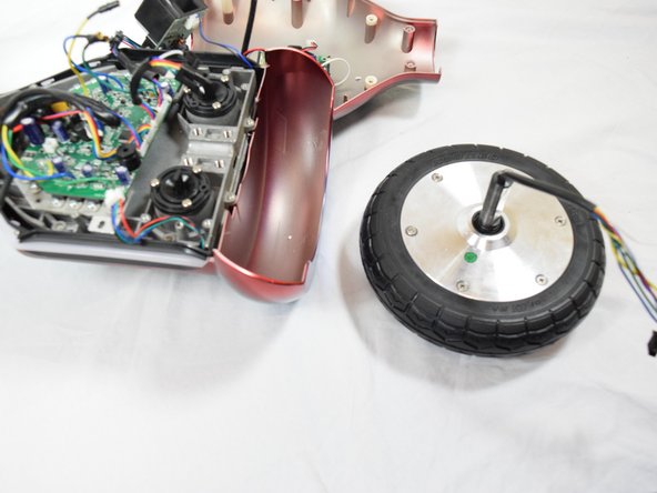

  13. Hover-1 Horizon Wheel/Motor Replacement: crwdns2935265:013crwdnd2935265:01crwdnd2935265:02crwdne2935265:0 Hover-1 Horizon Wheel/Motor Replacement: crwdns2935265:013crwdnd2935265:02crwdnd2935265:02crwdne2935265:0
    • Remove the wheel by lifting it away from the base with both hands.
