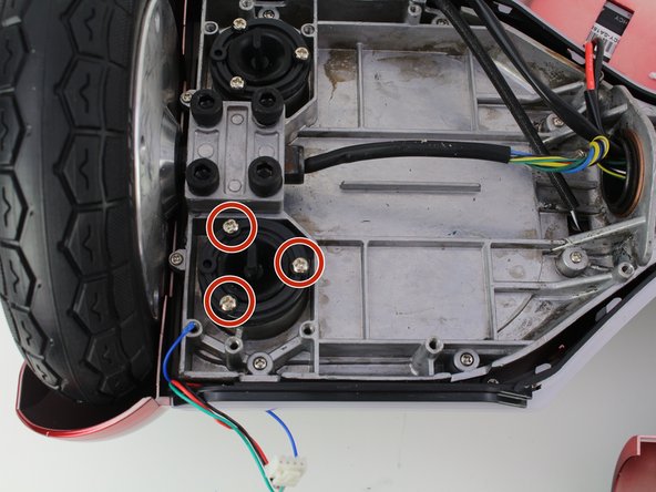

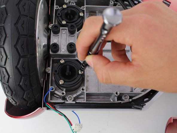

  10. Hover-1 Horizon Left Balancing Sensor Replacement, Left Balancing Sensors: crwdns2935265:010crwdnd2935265:01crwdnd2935265:03crwdne2935265:0 Hover-1 Horizon Left Balancing Sensor Replacement, Left Balancing Sensors: crwdns2935265:010crwdnd2935265:02crwdnd2935265:03crwdne2935265:0 Hover-1 Horizon Left Balancing Sensor Replacement, Left Balancing Sensors: crwdns2935265:010crwdnd2935265:03crwdnd2935265:03crwdne2935265:0
    • Remove the three 10 mm Phillips #1 screws connecting the balance sensor to the hoverboard.
    • The balance sensor tabs are made of sensitive rubber. Screw them back on slowly, and do not over-tighten.

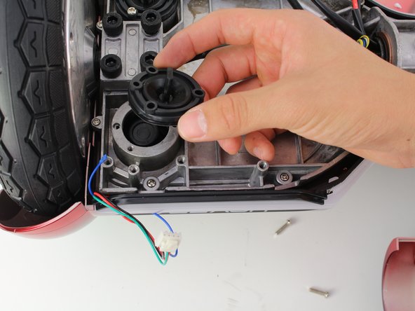

  11. Hover-1 Horizon Left Balancing Sensor Replacement: crwdns2935265:011crwdnd2935265:01crwdnd2935265:02crwdne2935265:0 Hover-1 Horizon Left Balancing Sensor Replacement: crwdns2935265:011crwdnd2935265:02crwdnd2935265:02crwdne2935265:0
    • Remove the sensor tab by carefully lifting it away from the hoverboard.
