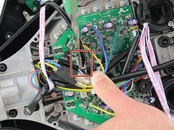

    • Using a utility knife, scratch off the hot glue from the connector attaching the red and black wires to the motherboard.
    • Be careful to not damage the wires or connector when removing the glue.

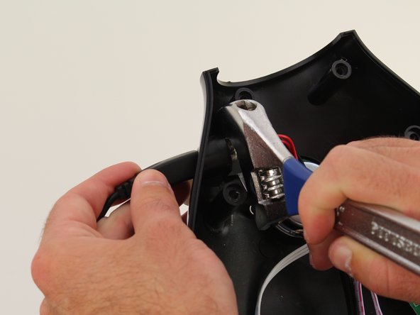

    • Using an adjustable wrench, unscrew the nut that is attaching the charging port to the bottom shell.
    • It might be helpful to put the charger in the charging port while unscrewing the nut to ensure that the port is not spinning.

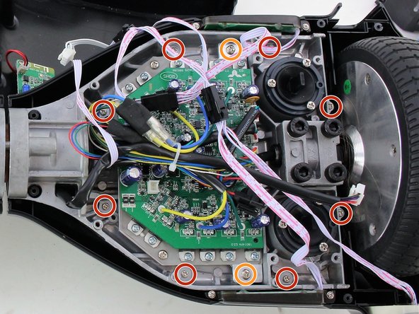

    • Remove the sixteen 10mm Phillips #2 machine screws by using a screwdriver to rotate the screws counterclockwise.
    • Remove the two 12mm Phillips #2 machine screws by using a screwdriver to rotate the screws counterclockwise.

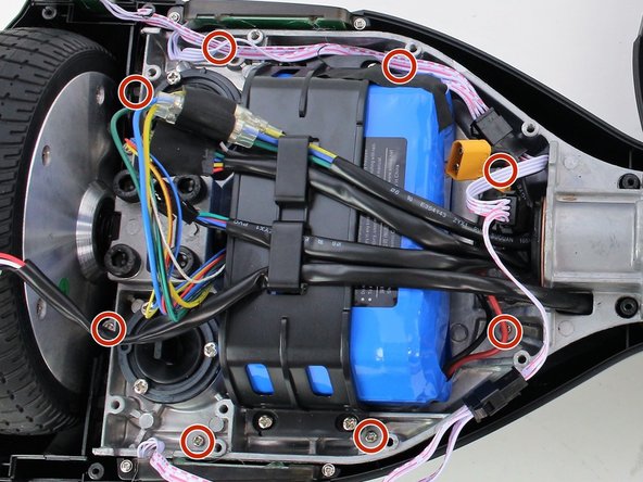

    • Remove the two 8mm Phillips #0 screws on the right half of the shell by using a screwdriver to rotate the screws counterclockwise.
    • Repeat for the left side of the shell.
